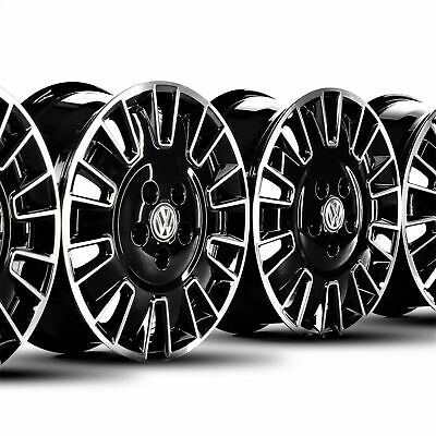

I was looking at the California website in the UK and noticed this picture. What wheels are these? They are incredibly cool but I didn't see them as an option when we specced ours.
Not what's coming up when I google Posada alloys.
Posada 7LA601025FZZ Aluminium Wheel Rim 17 Inch 7Jx17 Black

These are offered as an option in some markets for a Cali - clearly shown in the French brochure as suitable for Beach, Coast and Ocean .Screenshot 2021-04-12 at 22.17.15.png
