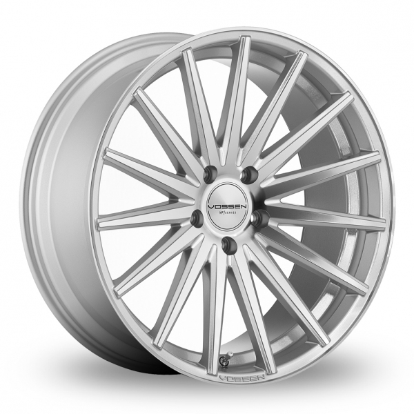

Go on wheelbase alloys and enter T4: you’ll be presented with a wide selection of lovely alloys to choose from... and £20 off with code VIP20
perfectly safe using adapters just more involved
