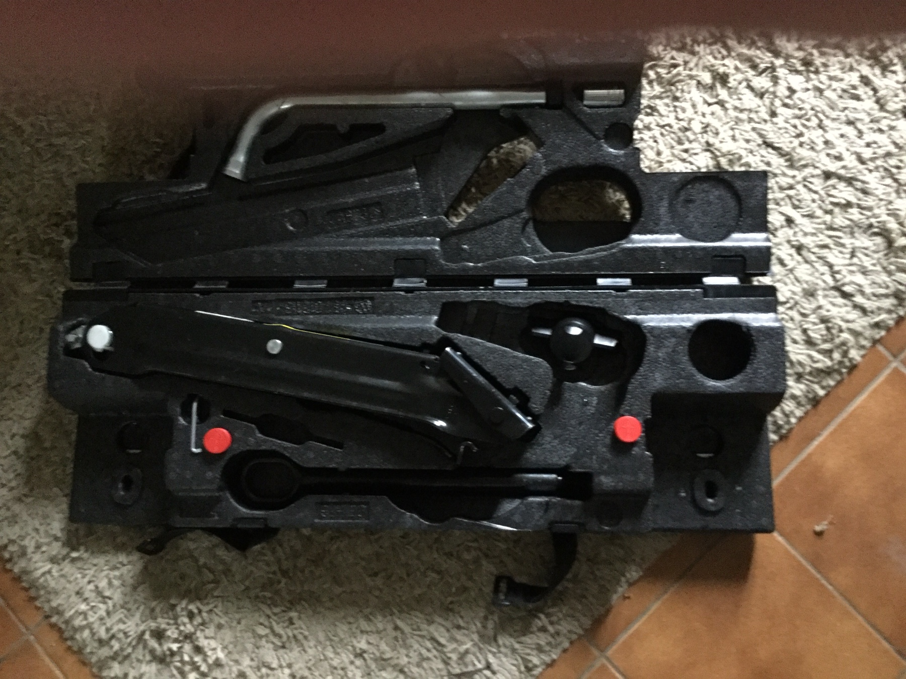

After my first, and last experience at the side of a steeply sloping motorway with a blowout and a VW scissor jack I’m on the hunt for a bottle jack. My scissor one is not fit for purpose and in any case it’s beyond my skill level to get it back in its box. Picture might help ?
In any case it’s going and getting replaced. When the breakdown eventually arrived it was a 10minute job with a bottle jack but I didn’t get the make of the one the guy used.

Found this old thread which shows a picture. I reckon mines bent as can’t get it to fit.
https://vwcaliforniaclub.com/threads/toolkit.10754/
Cracked it
