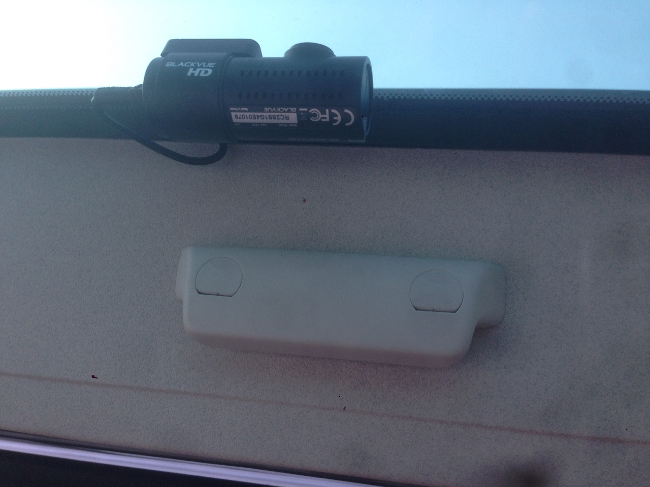

I like idea of combining the sat nav, RCD330 didn't fit so it's for sale, might take down the Garmin so I can combine all.
Here is the rear one.
Loads of room with no interference from blind.
Sent from my iPhone using Tapatalk Pro
I thought it would be a problem but it wasn't. If it's away from the glass you can get issues with reflection. I don't as it's tight to the glass. To get the wires in guy used a fibre optic to guide the wiring.
