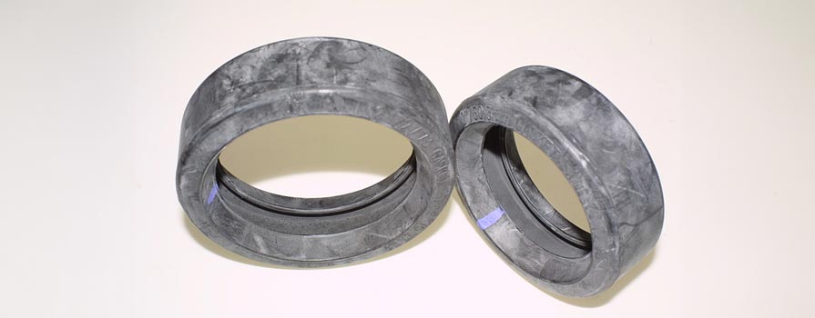

Most likely to be bloom, it’s quite common on rubber components.
Thank you: I think that’s exactly what it is and someone on another forum just said VW had an issue with it on MY 2018 vehicles.
Silicone oil, tyre shine or trim polish will bring it up like new (applied sparingly)
