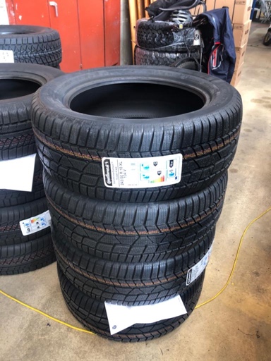

Friend of mine got some 235/65R16 Bridgestone... (do not knwo the model) and an other one some Conti R18 (picture).
Personal I need some narrow tyres because I sometimes need chains.

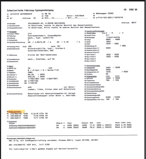

You guys are really playing with the sizes.
235/65 R16?
205/60 R17?
Not really VW approved sizes for the California.
Width and height differs.
Speedo completely offset.
But who am I to judge?
235/65 R16?
205/60 R17?

You never know what sizes they want to sell you.
The 215/60 R17 is VW approved for the California, so don't worry.
Just the 235/65 R16 should be the 235/60 R16, as stated above.
So you are all on the right track.
No problems.
I'd have thought a 235 on a 6.5" width rim was too wide, unless a typo and 17" meant.
You are right. Then you will need a different rim. 7Jx16 ET55, instead of 6,5Jx16 ET51.
If snow chains being fitted I'd suggest ET 50 or 45 to give inner clearances. If they can be found in 16"
I noticed that my 235's with standard 7" x 17" ET55 rim have little clearance on the rear inner arch.
