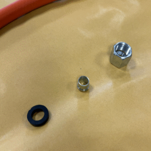

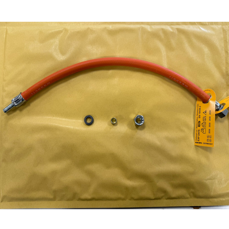

Pack includes:
1 x Main Hose Assembly
1 x Seals for gas tap valve
1 x Steel Olive
1 x Steel Coupling nut
All genuine Gok products are made in Germany
DVGW tested
These items must be replaced every five years

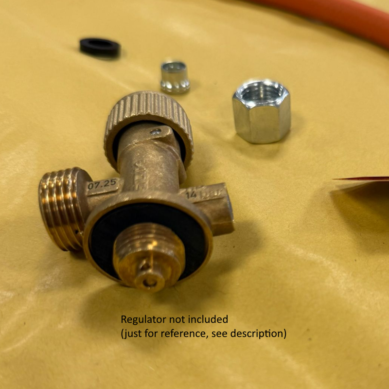

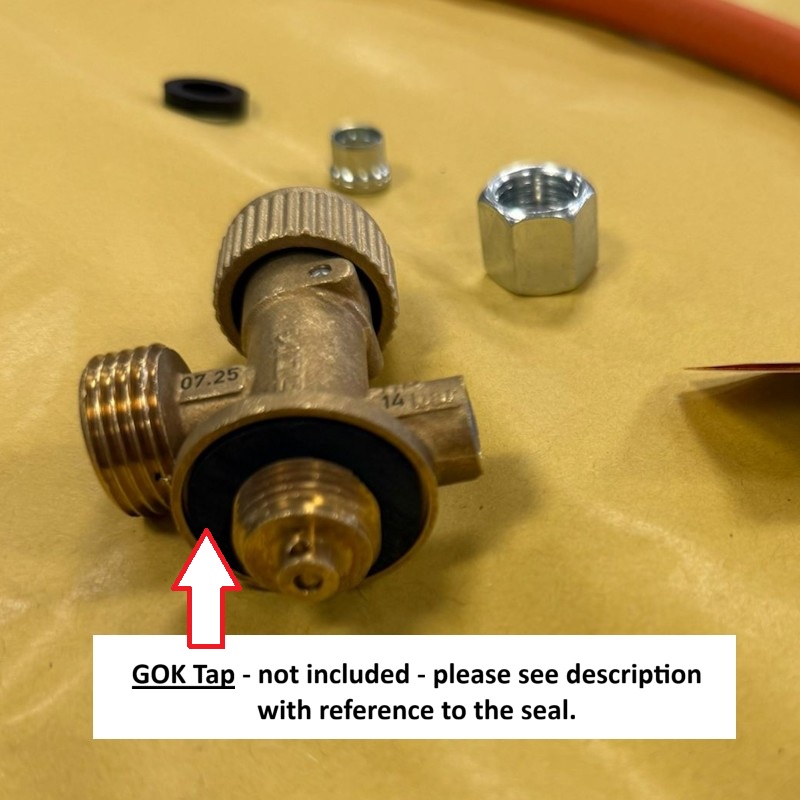

Please Note: Gok has discontinued the larger seal that we used to provide, meaning we cannot include it in the kit anymore. However, it’s the seal that can be found on the underside of the Gok tap / valve, so most users do not require this part anyway. If you do require the seal, you can purchase a Gok tap / valve from us 🙂
If you require the Gok tap / valve, click here
