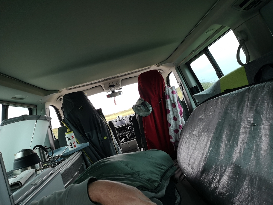

Beach: with 2 Seat bench,. Boards down the side.
Beach: 3 seat Bench, remove headrests + boards suspended from ceiling
Ocean: Chopping the top off the wardrobe would work (although a bit extreme, and would affect the value of the van), then would have an extended worktop instead and put the boards on top. Our T2 Viking conversion was set up like that and 5 of us used to manage for 3 months in France, but we didn't have bikes.
Wow, you keep a lot of stuff in your car ;-) I surf and I mountainbike, so I can relate. Considering you want everything inside a beach or ocean doesn't seem like the obvjous choice if you ask me. I don't know how big of an issue your budget is, but both budget and your requirements to me suggest that your best way to go would be to either buy a VW Transporter and convert it into a campervan yourself or let a (semi-)professional convert it for you. This way you can make it exactly to suit your needs.
The "problem" with the Ocean is that the seats and drawer take up a lot of volume. If I'm travelling alone, I put the bed flat and put my surfboards on there, can easily fit a 7'0". If I have passengers, the boards go on the roof but I guess that isn't an option for you. If you moved the seats all the way forward you would get your bike in but probably not your boards and you wouldn't be able to use the downstairs bed if you wanted to keep your bike inside the van at night.
Remove drivers headrest, rest the nose on the dashboard, put a roofrack strap around the roofbed to make a sling?
