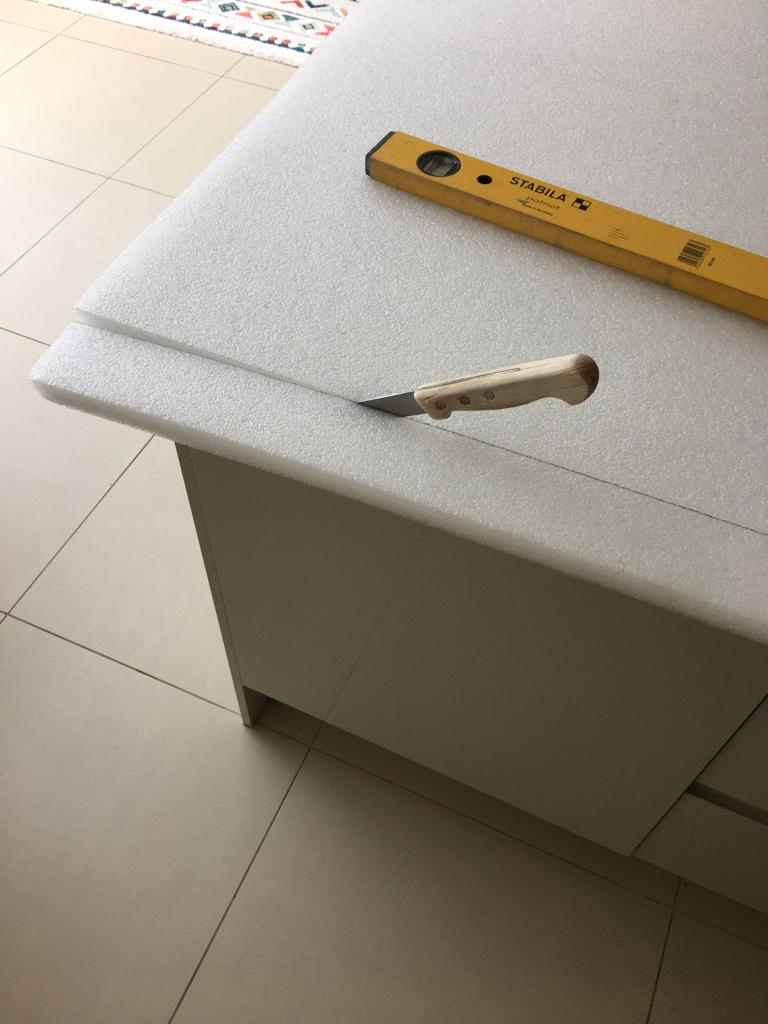

So I ordered some foam sheet (a bit like those giant rectangular floats kids stand op on in swimming pools. It’s also used for packing expensive AV equipment into flight cases. Anyway I ordered a 40mm sheet of this which would have done the job perfectly but it’s about 10mm too high, so have sent it back and await the 30mm thick sheet.
I’ll then draw around my rear parcel shelf mattress and cut the sheet with a sharp kitchen knife with a sawing action.
I’ll update when I get the 30mm stuff and check but I think it’s going to sort the problem perfectly for under £30.
The link: https://www.easyfoam.co.uk/ethafoam.php
The size: 100cm x 120cm x 30mm
Colour options: grey or white
So the foam arrived today - they actually sent me 25mm thick rather than 30 by mistake and by sheer luck it fits even better than 30mm would.
Unfortunately I forgot to change the colour to grey when ordering so it’s white instead but at £27 a sheet it’s not a major concern.
I then measured the mattress cushion and squared everything off those measurements, using a biro, straight edge, and a very sharp kitchen knife at a shallow angle with a sawing motion.
This gave a clean cut. I then notched around the parcel shelf supports, lifted the seat up and laid it back down on top of the foam so the seatbelt nobbles could be traced around.
Finally I rounded the back off to the shape of the boot but had I been feeling lazy I could have just used the rear edge of the parcel shelf to give me a slightly less snug fit.
It got dark as I finished but took a photo of work in progress. Suffice to say it weighs almost nothing, has a little bit of give, and is the perfect height. It’s comfy even without a mattress topper so will hopefully enjoy sleeping in the van this weekend!
Hope this is useful to anyone else with this same issue.
