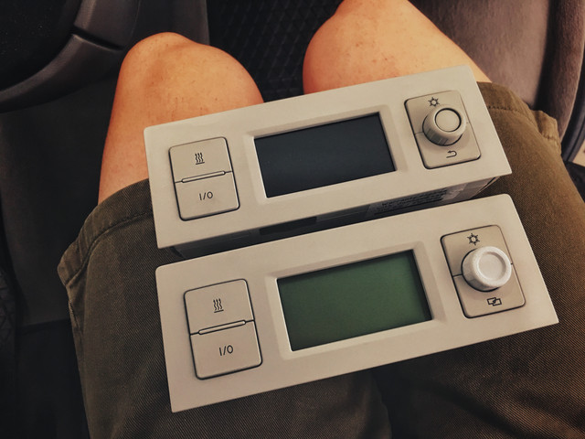

Just looked it up, thanks to a thread on here that mentioned oempc.com, part number is the same, so I really think there should be no problem! Really tempted to go for it, the only thing holding me back is the van also needs leisure batteries, and money doesn't stretch, unfortunately!
:cheers

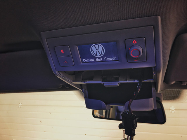

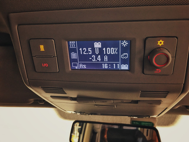

Just an update, ended up getting the 2015 controller, arrived yesterday, fitted it today.
5 minute job, turn it on, change the language and test everything. Works great!
Decided to keep it on there, and save the original one for a rainy day.
