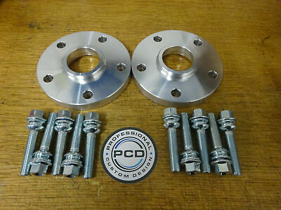

If you are set on the spacer route you could use these listed below, they do other widths but I couldn't see a 10mm with longer bolts, which I'd say were essential. Front and rear could have different spacers. 10mm front, 15mm rear. No doubt you could contact them regarding longer bolts (no lock nuts?)
Not a route I'd go but >>
40mm is huge spacing, 10/12mm would be best on standard wheels maximum....
Wider wheels and different offsets do not require additional length to bolts and adding 40mm to standard bolt length alone isn’t ok in my opinion regardless of extra load on bearings... how ever devonports do look great and those calis look cool Subtle tweak on the original look is best I do not like aftermarket anything on any vehicle...
