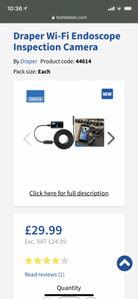

What endescope do you have?
I have always wanted to get one but never know which one.
I have one of these.
