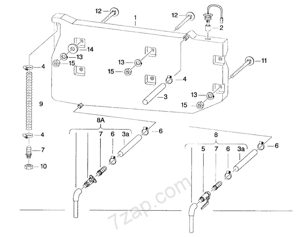

Hi, does anyone know how to access the grey water tank in a 1992 T4 california or have a plumbing diagram? My drain was draining very slowly and after pouring some drain cleaner down it has totally blocked up. Using a plunger I just feel resistance and the water does not move at all. I see that the drain cleaner I purchased reacts and creates a lot of heat so I think a pipe or something has melted. I think I'm going to have to take it apart, but have no idea how to access the tank or how it's plumbed.

I don't think you have a grey water tank, just a pipe from the sink to a drain valve under the van. Take a look at the end of this video...
This may help ...

So the grey water tank is slow to drain? Or the sink? If it’s the tank the chances are it’s simply got a blockage in the drain valve. Easiest thing to do is open the drain valve, connect a garden hose and push water back into the tank. This should unblock the valve but you’ll need to put something in the tank to break down any of the contents that may cause blockages in the future.
Thanks for the diagram. The sink was slow to drain and the the tank as well. I was able to plunge it to get the water to drain from the sink before I poured the drain cleaner granules that generated a lot of heat when it contacted water. The pipes from the sink to the tank are all unblocked. I just don't understand why the plunger now just doesn't push any water out of the overflow outlet. From the look of the tank I just don't see how even if the drain cleaner melted something inside how it could block both the overflow and regular drainage. I'll dry the hose up the outlet trick. Thanks!
After a day the tank just suddenly unclogged itself. It doesn't seem like a full tank worth of liquid though.
Good news. The waste tank can hold around 18 litres. Which might be why you’ve never been able to get it to come out of the overflow.
