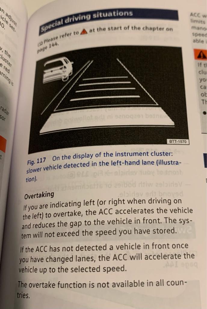

When a car comes into range, it will display the car icon with bars to show how far/near the car is ... essentially informing the driver that a car has been detected. something line the pic below.
Am I correctly interpreting your statement as - does the display detect a car and show the icon as above, when there is no car in front, but there is a car in the left or right lane? - in which case, you are right, it most probably points to a mis-alignment issue.

I have exactly the same on my T6.1. Car shown in the display offset to the left of a car in front. It is definitely seeing the car to the left and seems deliberate given there is a visual indication the car is to the left not in front.
Happens on dual carriageways for me - suspect it’s when the lanes are narrower. Really not nice when it starts breaking as you are overtaking.

Yes, T6.1- mine shows 2 cars next to each other ie what you’ve shown as the straight ahead car & then another to the right of it at times. Never seen one shown to the left.

Shows better if you have the adaptive status as the main display between the dials, rather than as the small display below a map or other info.
Looks just like the above image.

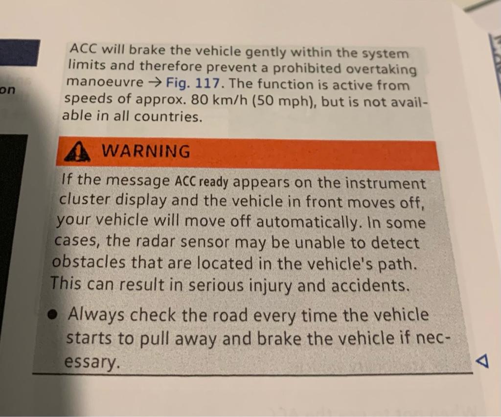

And this top para clearly describes exactly the behaviour only of course I’m overtaking not undertaking :)
It’s a brand new 6.1 2021. As said earlier. My 67 golf had exactly the same system and worked without a hitch for 4 years, it’s perfectly normal on the infographic for the radar to spot cars lef and right when in the middle lane on the motorway, and it will never undertake, but now it’s braking as if it thinks it’s undertaking the cars in the slow lane…. I don’t think it’s a sensor alignment issue.
i could do with trying to reset it, or pulling a fuse!

The no undertaking feature is intended, trouble is the OP seems to have no overtaking set as well!
No undertaking is easily over-ride either by pressing on the accelerator or using the indicators.

For me its acting like I'm undertaking when overtaking, and my presumption is that undertaking prevention is only supported for left hand drives and can/should be off for right hand drives.
I believe that selecting travel mode should work for abroad. ( edit: further investigation has found that although the manual refers to travel mode, it does not appear to exist!)
However my manual is not too clever on that front as the index refers you to page 103, page 103 says refer to page 32, page 32 says refer to page 103.

interesting. I see no mention on either of those pages of travel mode. Manual edition 07.2020 (I have a MY21 built October 2020)
