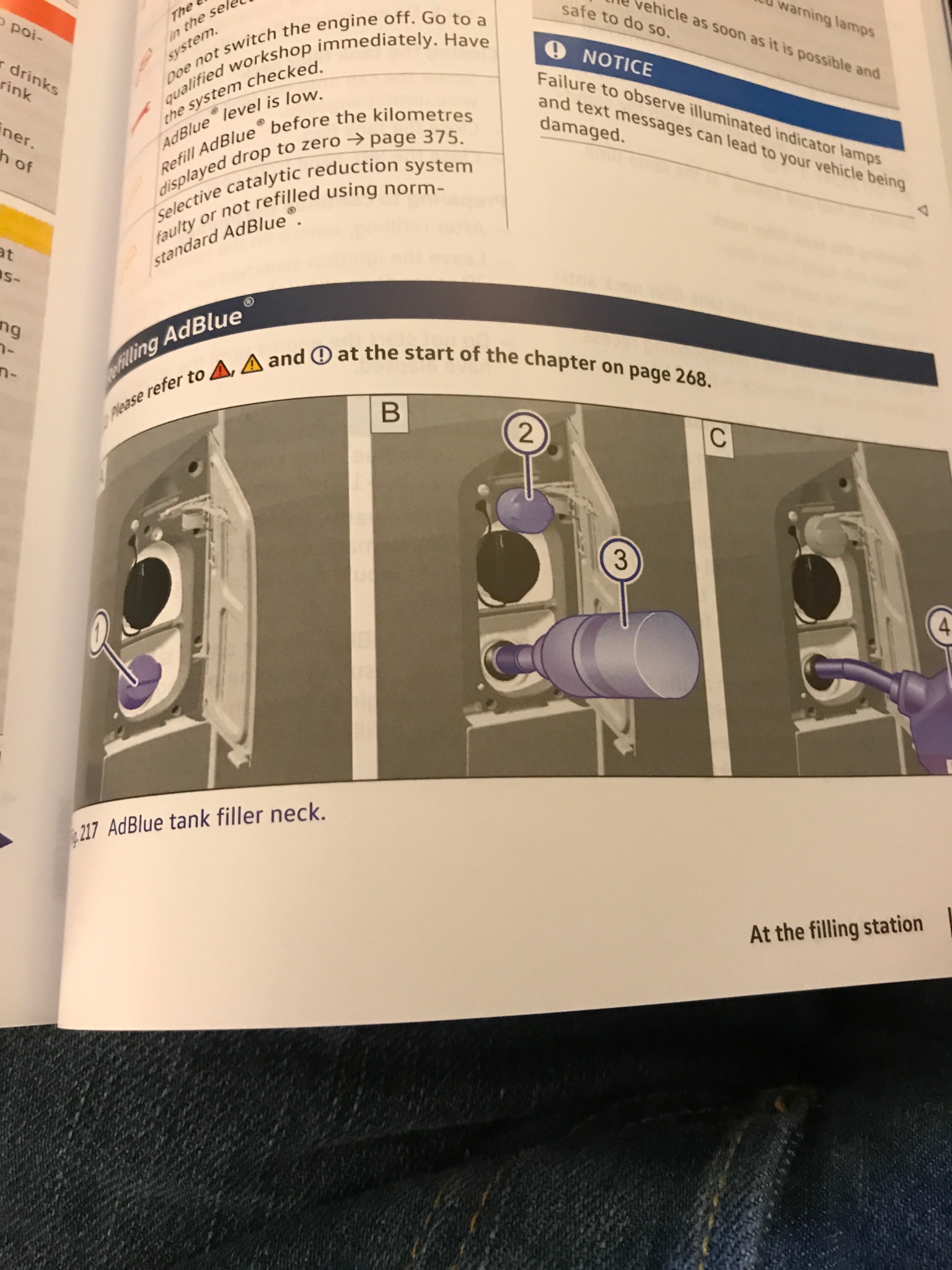

Hello - mine is saying I need to fill with adblue soon - do I need to go to Vw for this or can I just buy some and pour it in - or is there a gadget for getting it in cleanly please ? Any advice would be much appreciated - thks Tim

You can buy it at filling stations. Filling as below.
We waited until it said 1200 miles left, bought the big container (10l?) in Halfords, nice bloke came over and chatted about it...was happy I'd read about it on here.
Pouring it in worked perfectly with the spout that came with it and was no issue. Might be problematic if you're not able to lift the container?
Husband had worked out that the 10l would be enough to fill the tank and it was, range 6000 came up.

Buy a big bottle the next time you fill up with diesel after the MFD reminder comes on, pour it in, forget about it for 4,000 miles.
Did it this morning, no harder than screenwash - whole AdBlue topic is the biggest “fuss about nowt” ever.
