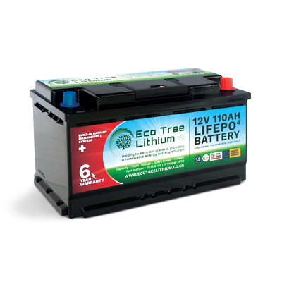

This is the battery I have been using successfully, straight drop-in.
Eco tree Lithium Iron Phosphate EL12.8-110AH

Oh god....so confused. So @domijchayhoe you have simply dropped in one of these
and all fine?.....correct.
