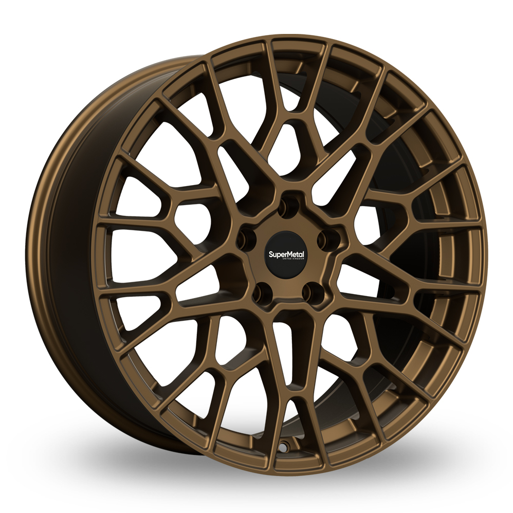

Our Ocean delivery is imminent and just as I thought we had the spec nailed down my wife decides the Woodstock alloys we specified just don't give the van the look she wants so we've been scouring the internet for alternatives. I dont want to go any larger than 18" as I still want a decent 'comfortable' drive. The alloy we both liked is an 8j x 18 SuperMetal one which requires 255 x45 R18 tyres. This would mean a 40mm wider tyre than what it will come with. Would this have any effect on turning circle, or the actual fit to the van , in the arch?

You need to check the offset of both wheels. There are online tools to compare different tyre sizes and offsets.
255/45/18 is a standard fitment width so that in itself is no problem but if not a VW alloy then you need to check the offset.
17s can be fitted with 215/60 or 235/55’s
Supermetal site gives load rating as 900kgs (1800kgs per axle) and Offset of 30/50. 50 would be suitable as 30 would protrude too far out. No info on centre bore.
Only thing to consider is that they are 8.5" wide, VW factory use 8" width. Slightly more risk of kerbing as tyre more square to the rim. Many Transporters have 20" rims with 9" or more width and 275 width tyres.
Looks like a go'er, for me.

Super Metal alloys in the size you have chosen but with " 235 " General grabber At3 tyres.
I chose 235 rather than 255 "At " tyres as I was worried about the sliding door catching.
