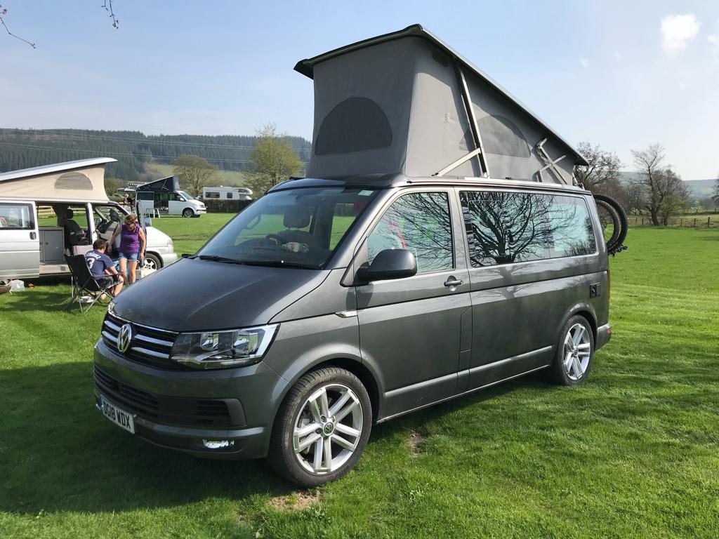

Nope. Just these 19’s off an Amarok.
Looks great I’ve been looking at these too, can I just ask if these are a straight fit without using spigots etc and can you use the standard oem bolts ? I was also wondering does the side slide door clears, as the cali’s door has thicker interior so catches if the offset is to low from what I read never knew wheels could be such a minefield:(
Yes, straight fit. No mods at all. I don’t think I needed new bolts (4years ago now) but was dead easy anyway.
Remember that the big front brake discs need a minimum of 17" wheels.
Fitted to 180, 204, 199 and now the 150 but check what you have before buying wheels.
Amorak wheels have a lower offset (10mm) than Transporters. Equivalent to spacers on standard wheels.
Just be aware if fitting nobbly tyres as more dirt up van sides.
