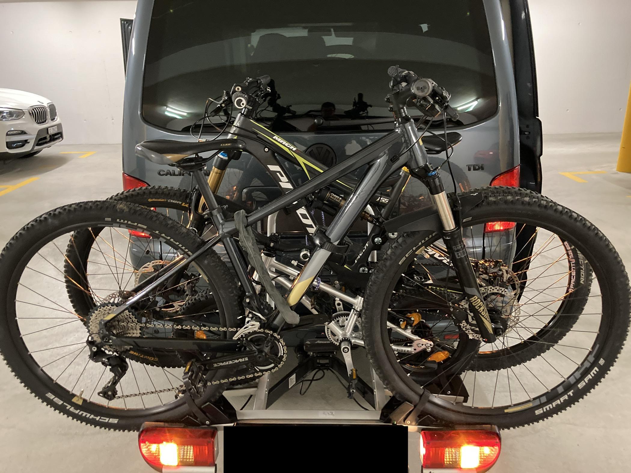

Took this pic today:
2 adult bikes (27.5&29er) and in between a kids bike 14". Turned his bar anf everything is good!
Happy because I thought we had to buy the extra rail... well not for now.

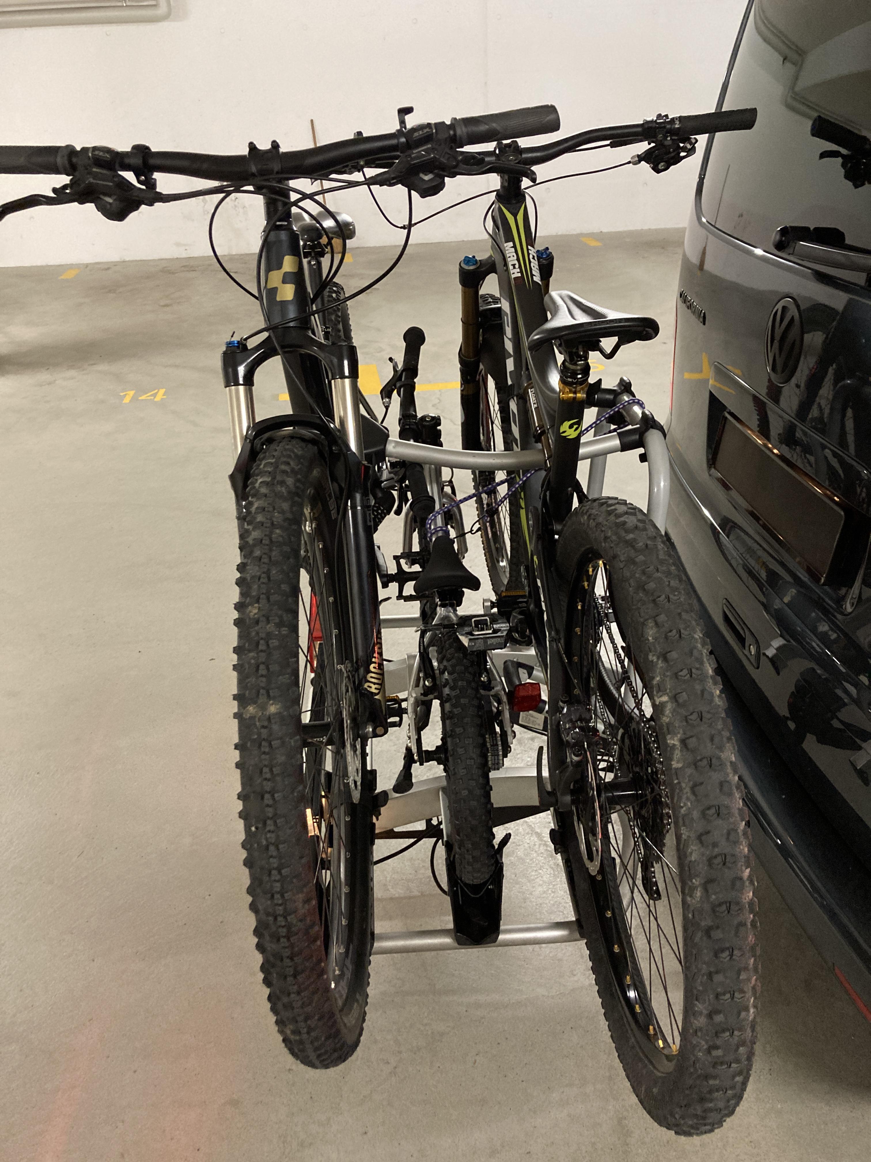

From what I've read here the ATERA STRADA DL 3 +1 seems like an interesting option. Weird question: do any of you who own it think it would fit on the towbar, with bikes, while leaving the original bike rack in place (folded up). Might seem like a weird question, but I once tried a friend's towbar rack with 3 bikes and that fit while my original bike rack was still in place.
It would make it easy for me to keep using the old rack for weekends / mtb trips with friends, cause I wouldnt have to get the Atera Strada out. But also allow me to use the Atera Strada 3+1 when going away with the family, takings 4 bikes, without having to remove the original VW rack. ;-)
These photos should help, there is only 210 mm clearance at the top of the 3DL. Depends how high the VW one is. The 3DL comes up to the just below the bottom of the VW badge.
Note I extended my 2014 3DL as the bigger mountain bikes with 29" wheels were at the racks limit, maybe the new ones are wider?
Thanks so much! That gives me a real good idea of whether or not this will work. I will go and measure my bike rack now ;-) And thanks for the info about 29 inch wheels, cause all my MTB's are 29 inch.
It's not just the 29" wheels it's the stretched out geometry. You would think the newer ones would take that into account.
Otherwise, try to get hold of a longer tow bar like me
I have a Westfalia tow bar standard as the 4th picture and bought a second hand tow bar of a Nissan Juke of westfalia.
Result in the last picture
