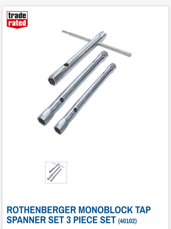

Going back to the faucet I haven't had chance to check but I would imagine that it will be the usual super awkward threaded stud and bolt fitting. For which you will need a plumbers box spanner set see attached:
The best of luck!!
