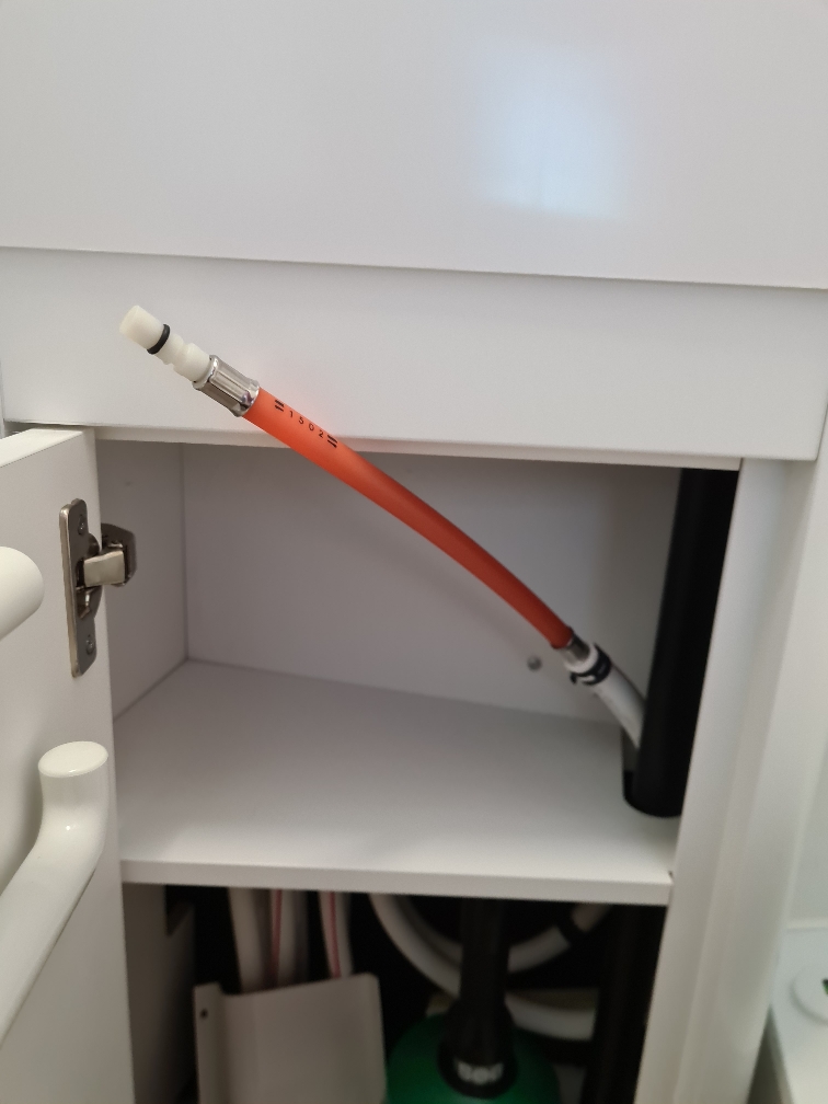

So I had a bit of a delve this afternoon with my basic van toolkit - I removed the side inspection cover and gently tugged on the water feed pipes and the hot pipe dropped off.
So I think I've found the leak - see pic below. It looks as though Reich design the tap tails to 'pop-off' to prevent damage to the tap in the event of a freeze - phew!
I still need to get the sink top off as you can't reach the bottom of the tap properly in-situ.
I managed to take all of the securing screws out bar one with my basic tools so I'll have to wait until we're home to finish the repair.
I'll keep you posted with more info and pics as I make more progress

Quick how to below:
- remove sink unit and bowl (4x Allen screws under the sink and use a scalpel to cut mastic. Bowl 4 more Allen screws)
- completely remove the tap (you'll need a plumber's spanner shown in the picture below)
- note the tap tails will not push back in because they are secured by a stainless steel location pin (shown in pictures below) which locates a collar on the nylon tail connector. You'll need to access both sides of the tap to remove the pin. Hence having to remove the tap
- remove stainless location pin which is an easy push fit (use a 3mm Allen key or similar)
- push the nylon tail connector back in (a bit of silicon grease will help but it's an easy push fit). Push the location pin back in
- make sure all 3 pipes are secured correctly
- reassemble and enjoy your non leaking van.
Anyway I hope this helps.
It's a bit of a faff but definitely doable if you take your time don't try a force things.
