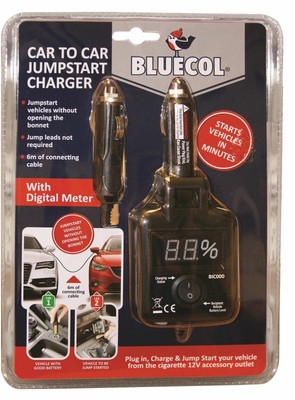

Does that mean I could swap the spilt charge relay under the passenger seat of my T5 Cali with something like the link below and it'll do the trick?
