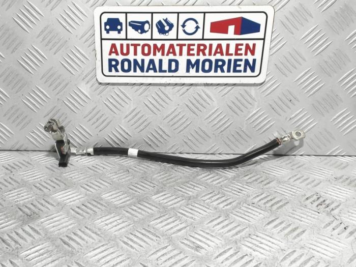

I take it the additional second sensor will be a VW part and consequentially horrifically expensive?
Probably around £50. You will also need to reprogram the special vehicle control unit. And run a data wire and make up the two pin plug.
How can I re-program the special vehicle unit?
Vcds in theory. Not many examples to follow though.
I think this is the OEM part (7E0915181N)
