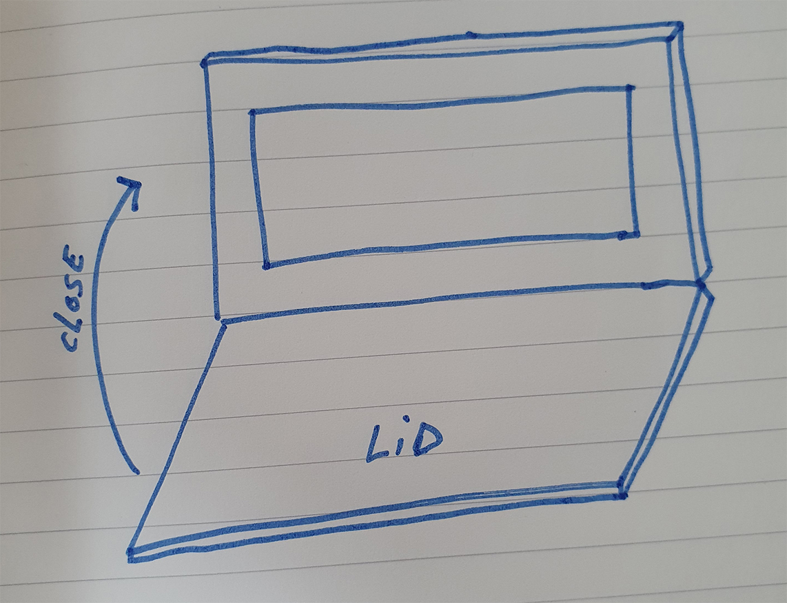

Personally I would not try to find a metal T5.1 or T6 frame. I would think they'd be quite hard to come by. I would also not cut a hole in your existing wooden board. I would get some wooden plating, copy your existing board and make a hatch in it. Should be easy enough, since you have the original.
You can make the closure of the hatch in such a way that when the hatch is closed, it can take the weight of people sleeping on it.
Like so:
(I can't draw at all, mind you)
