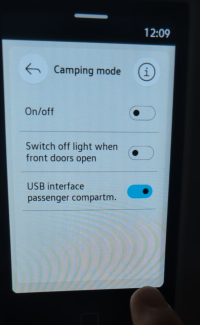

We are parked in a camp in France and the vehicle is plugged in power however we still can't USB c charging points in the vehicle for charging mobile phones etc...
I dont know ow what the camping mode does but I have tried with it being switched on and also off.
The only way we can get power to USBc seems to be by pressing the ignition button (not starting the engine though).
Is there a way of having the USBc working without pressing the ignition button and also what are the pitfalls of having pressed the ignition button (air con off and also switching off the light)

I also meant the usbc ports on the back doors (for passengers) and also the one in the top up roof.
All of the USBc ports in the car.
Try turning camping mode on from the California app on the phone or on the screen in the rear.
I just checked and it turns on the four USB-C sockets in the rear (On Ocean spec)
