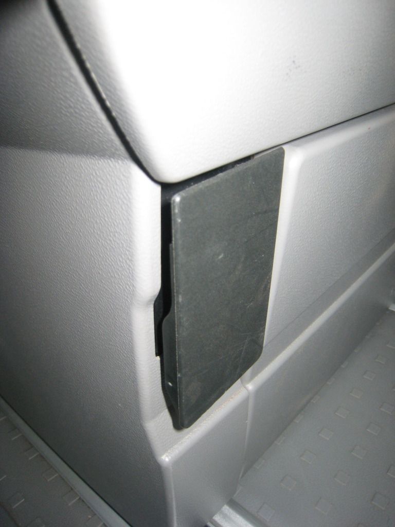

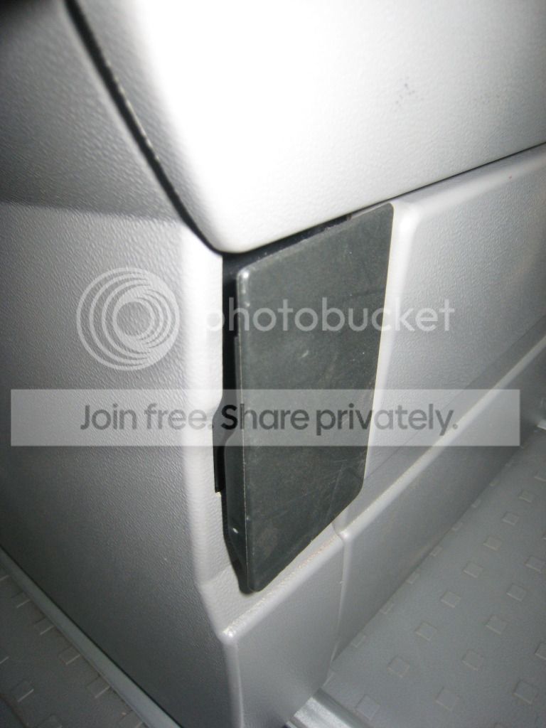

We removed our rear bench yesterday to pick up a sofa with our Cali. Only problem I now have after refitting it is that the handle that unlocks the seat, when sliding it on the runners, sticks out and will not return flat. It operates OK and the seat locks in position but the flap handle is not being fully pulled back to its starting position. :headwall

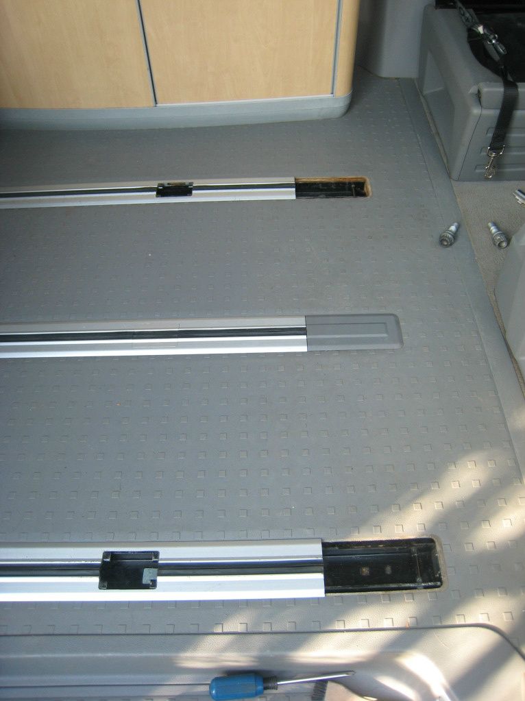

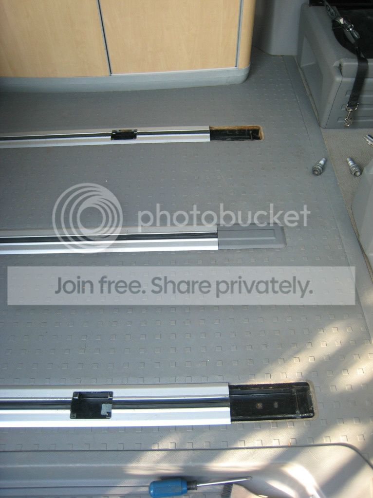

I had to take seat out again. To do this you removed the six covers, on the tracks, and then remove the front stop which is in the track by the cupboard. You then positioned the front seats as far forward as they will go. Then put a Philips screwdriver in the hole at the side of the seat. This keep's the seat unlocked so it can be moved forward to the gaps in the runners.

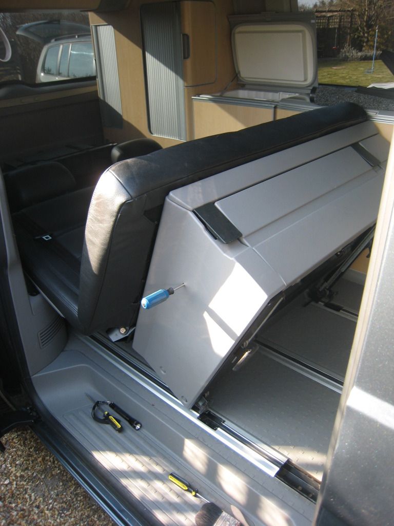

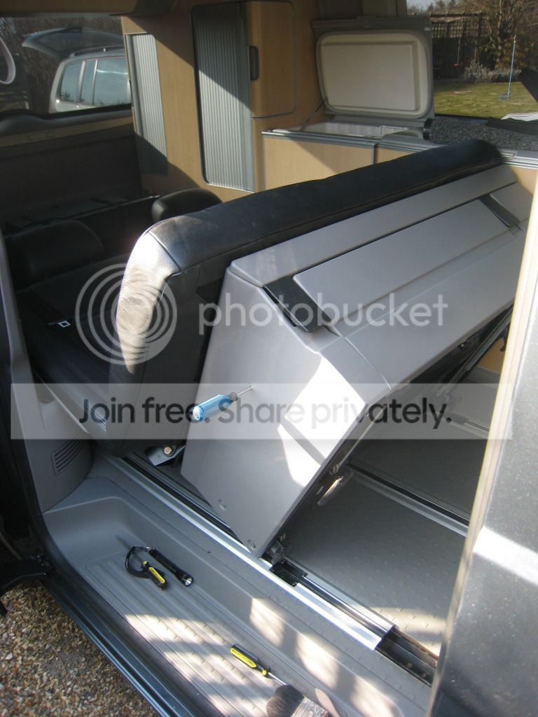

Rather then remove the seat, see previous post for why, I managed to simply tilt the seat onto its back in sit u so as to get access to its locking feet.

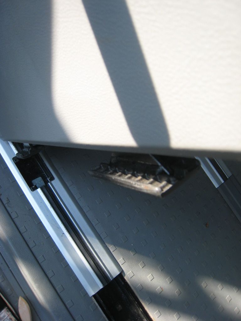

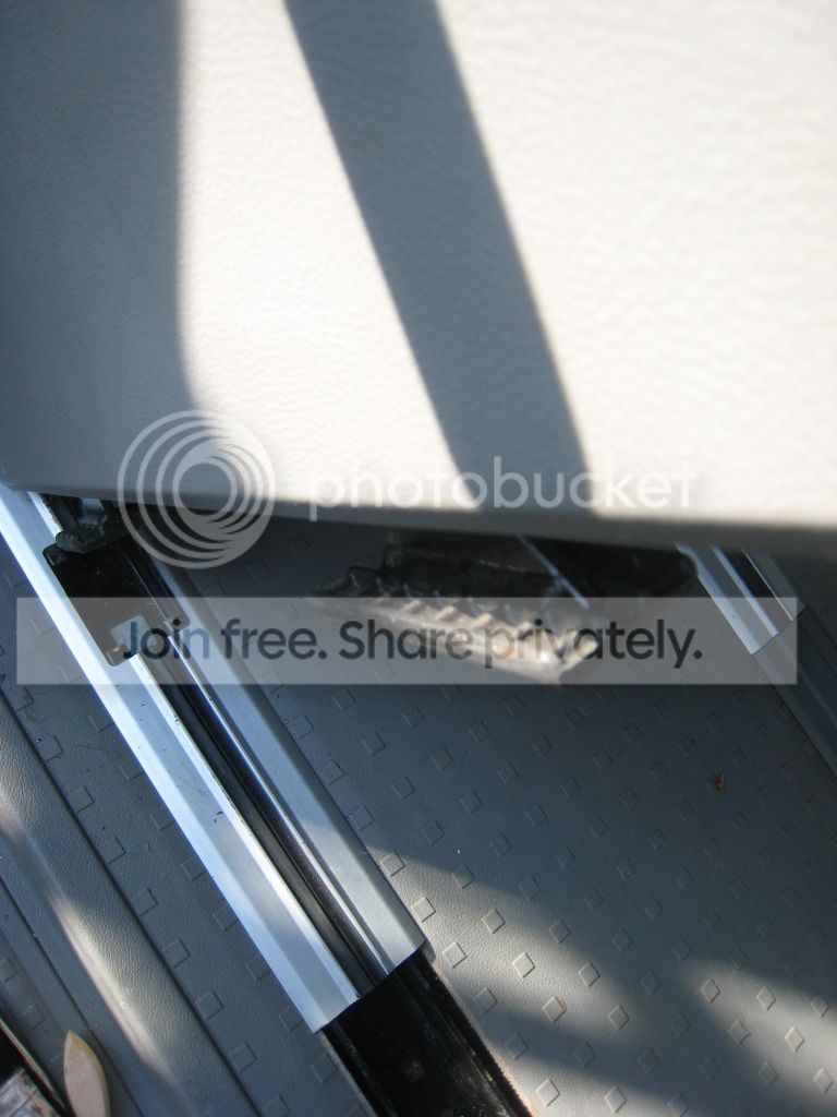

The feet of the bench are in the shape of a upside down T and they have cup shaped groves on them which lock the seat in place under the seat runners.
[img
[/img]
This is where I found the cause of my problem. A tiny stone had made itself at home in one of the cup shaped groves. This was all it took to stop that foot/track locking and the whole seat mechanism returning to its starting point fully locked position. That was why the seat handle was sticking out. :crazy
