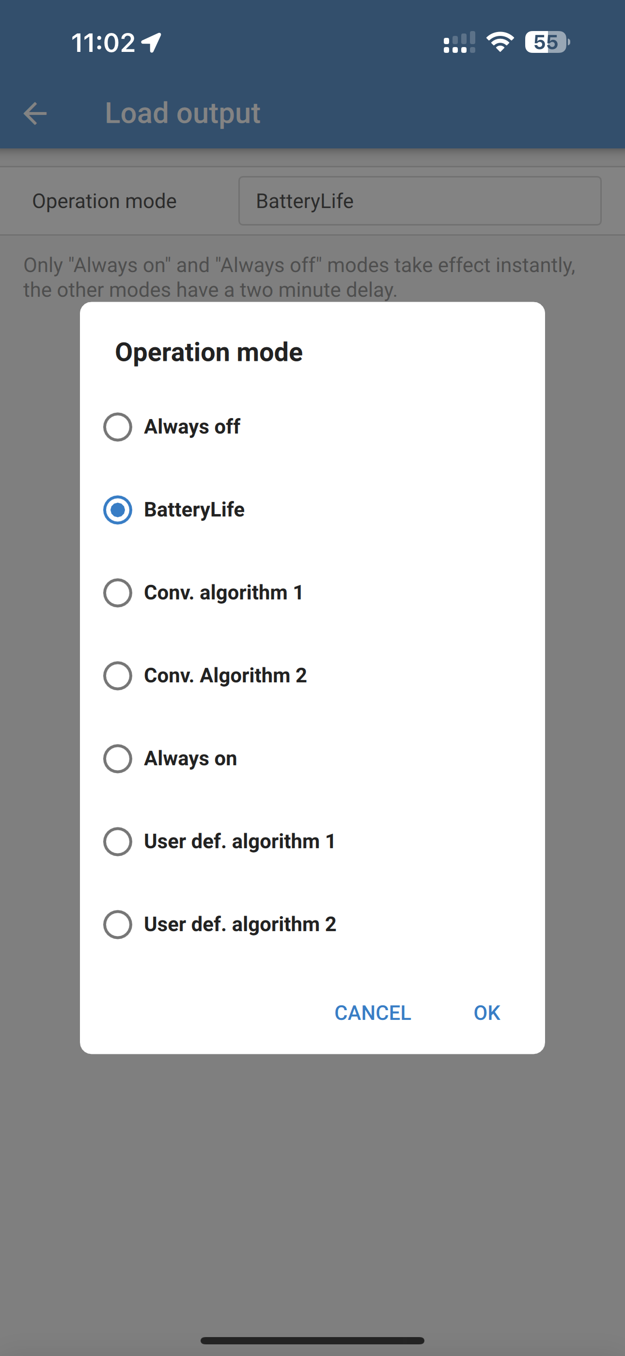

Under the “Load Output” setting check that this is set to “Battery Life” and not “Always on”.
