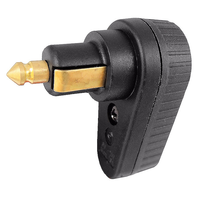

Our fridge plug has just enough space to slide the MFB; You could replace the fridge plug with one with a 90 degree bend, if you find yours keeps catching on the MFB:
Our fridge plug has just enough space to slide the MFB; You could replace the fridge plug with one these (or similar), if you find yours keeps catching on the MFB:
Well, it doest catch any more, now that it's in 2 halves ;)
Thanks: an L-shaped connector could solve the problem.
I might have posted the wrong link, but a 90 deg bend will solve it.
