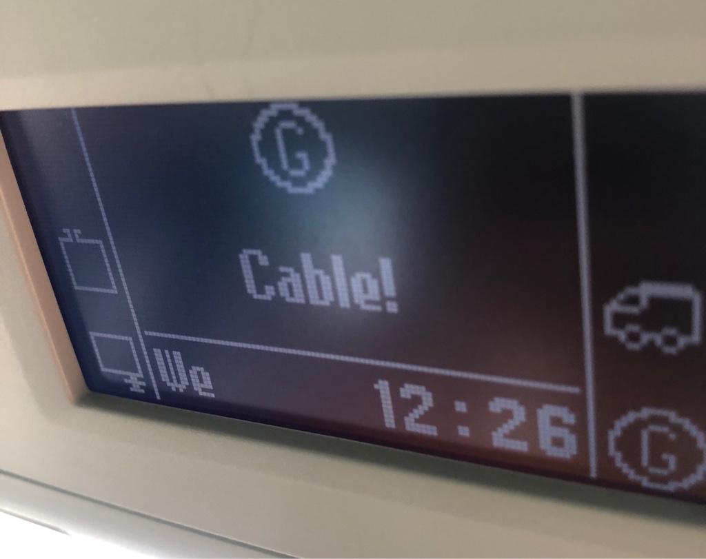

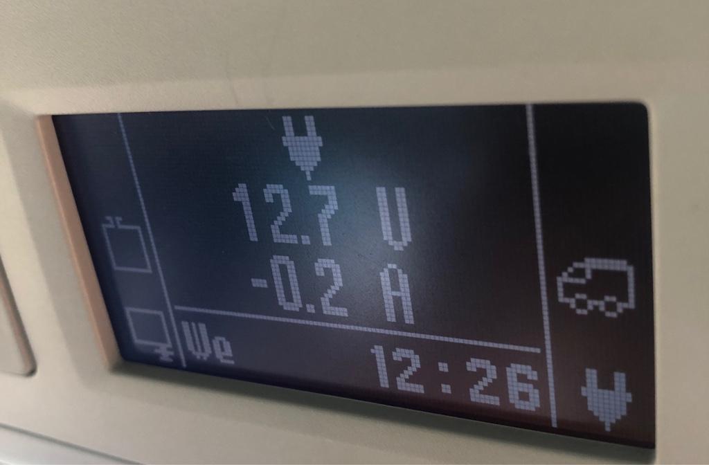

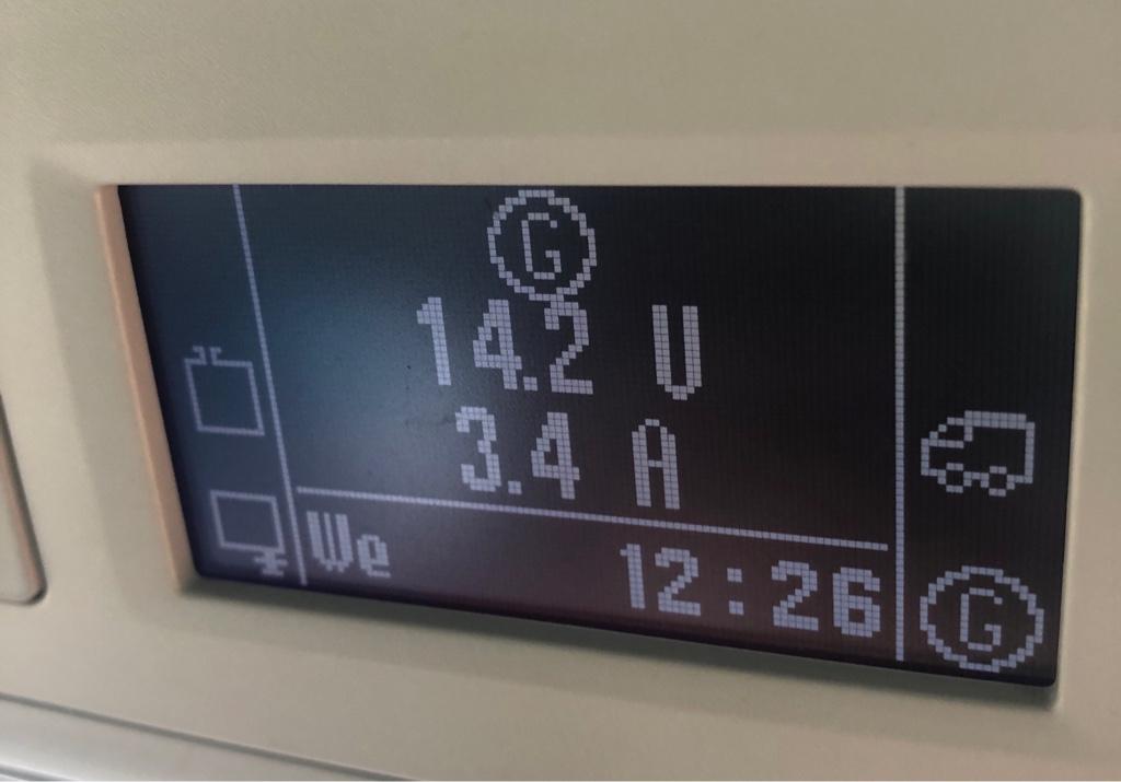

Hopefully someone can help. When the engine is off the control panel is showing the hook up cable is connected when it is unplugged. When the engine is running it shows to be charging as normal but there is the annoying Cable! Warning beep because it thinks the cable is plugged in.
Everything is working as normal on and off a hook up. There are no errors on the control panel diagnostic and a reset hasn’t cleared it.
Any suggestions?
