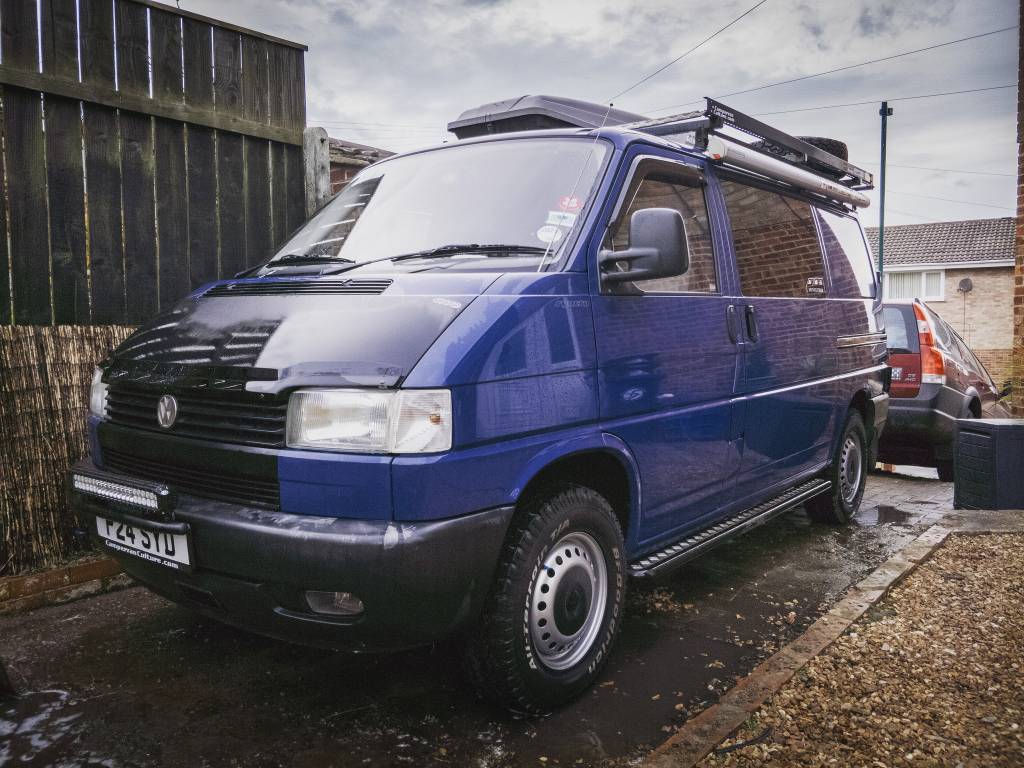

I've just fitted the Seikel lift kit to my Syncro back in the UK. I'd heard the kit gave a better ride than others due to the special shocks. It's about 35mm overall which is just about right. Not cheap though but worth it for me
