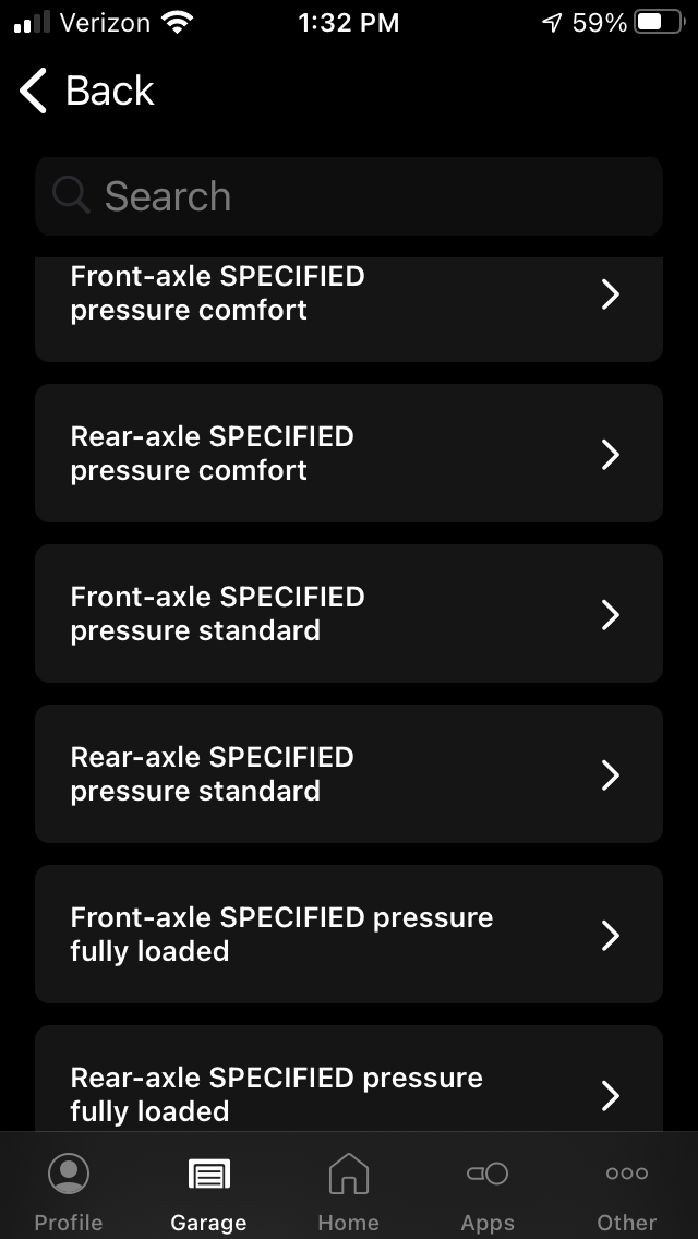

Whoop! You had me curious how to reprogram my TPMS minimum pressures (my mechanic said it can't be done) and I found a way. Mine is a Transporter based van with real TPMS sensors. I followed this article as I have an OBD11. I wanted to set min before alarm at 2.9 bar.

yeah, the Cali is different from the Transporter though. I constantly get alarms if I drop below the min threshold even if using OK. So this was my fix.
