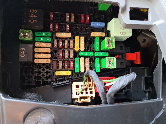

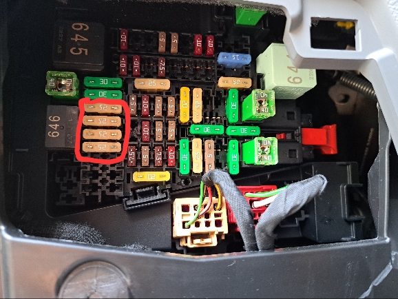

Try resetting the Control Panel by removing then putting back these 4 fuses. All must be removed the all replaced, not 1 at a time.
Dashboard fuse box Drivers side RHD so I presume Passenger side LHD.
Looks different

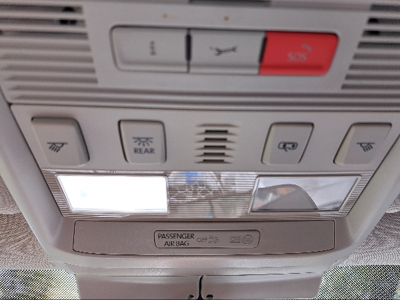

Worth checking that you haven’t got the “rear” lights switched on on the light switch panel - the conventional car light switches not the camper control panel? There seem to be a couple of ways of confusing yourself with combinations of manually turning individual lights on or off and also using that “rear” switch..
I can't comment on the fuse board difference. @WelshGas is generally right on these things.
But I do wonder if you have all the light switches correct. There are two on the side of the kitchen (behind your drivers seat) as well as the more obvious ones by the lights. This video is useful:
Try the switches close to your rear view mirror / emergency call button. That's normally the problem on a 6.1
That's what did it for me (quite counter-intuitve though, the switch must be pushed in to have the lights out ..)

It was working fine after removing the 4 fuses. And again, after one week, thay refused tho shut down. I make a appointment with the dealer.

The T6.1 lights are needlessly complicated. Operation is different depending on if the button by the rear view mirror is in or out. There is also the courtesy delay when opening and closing door, which is different again if in camping mode. I'm not saying you don't have a fault, but might be worth spending some time ruling things out before a trip to the dealer. Especially if the dealer is a fair way away. How do you have the button by the rear view mirror set? Do you have back seat fiddlers muddying the waters?
Yes, the button by the rear view mirror where ON. When you push the button in, it is OFF .They override the other setting. Even the "all lights off" touch screen.
