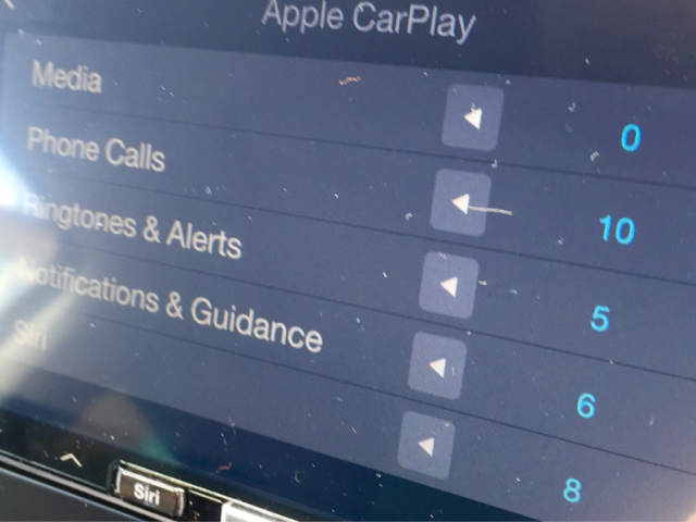

Andy - as a fellow Alpine iLx-700 owner, if you're around I'd appreciate your thoughts on a problem I have - when using Maps I can't turn the volume down. It's just too loud and turning down the volume on the unit's volume control had no effect. I've gone into Map settings on my phone where I thought I'd found the answer as there are options there for volume level - sadly they have no effect!
Any ideas? I've tried googling with no success :(

Hi Ian
I don't have any of those issues but then I'm in town and have 4G most of the time. Siri needs Internet to analyse what you're saying dynamically otherwise it would need huge amounts of storage to do this locally. It should be made clearer and it's why it gets fuddled when you have poor connectivity (or doesn't work at all!)
Re the maps volume hopefully these Screenies will help. Plug in the phone, get into CarPlay then hit the return button (next to Siri)
Tap the audio icon at the top (the one with the cog and speaker)
Scroll down to Application Volume, tap it
Scroll to Apple CarPlay, tap that
Scroll to Notifications and Guidance & adjust
Sorry for the quality of these I had to take them with my tethered phone whilst it's plugged in via the tray above!
I'd get the unit checked regarding the full volume on power on, as that seems wrong.
Hope this helps
Andy
Andy that's brilliant thank you so much for that - I've tried it and it works!
