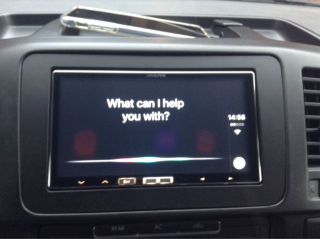

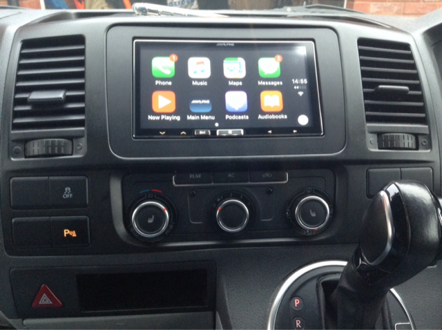

FINALLY it's in!!
First impressions of the iLX-700 is that it's a superb bit of kit. @fred I can only dream what yours sounds like now you've upgraded the sound system! I found there's a marked improvement over the stock item (standard speakers) using the media expander and playing with the EQ.
Somewhat annoyingly I've spent all day today in London (via train!) so I've not been able to play with it or take any pics.

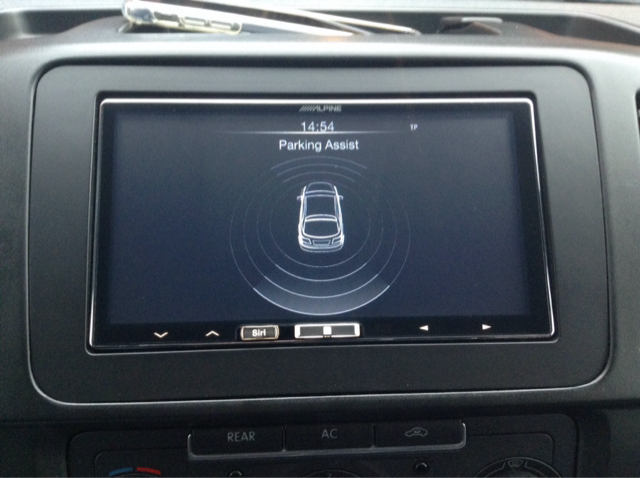

Apple Maps looks gorgeous at night and works pretty well. Parking sensors all displaying nicely. So far so good!
I shall post pics when I'm in the bus, in daylight!

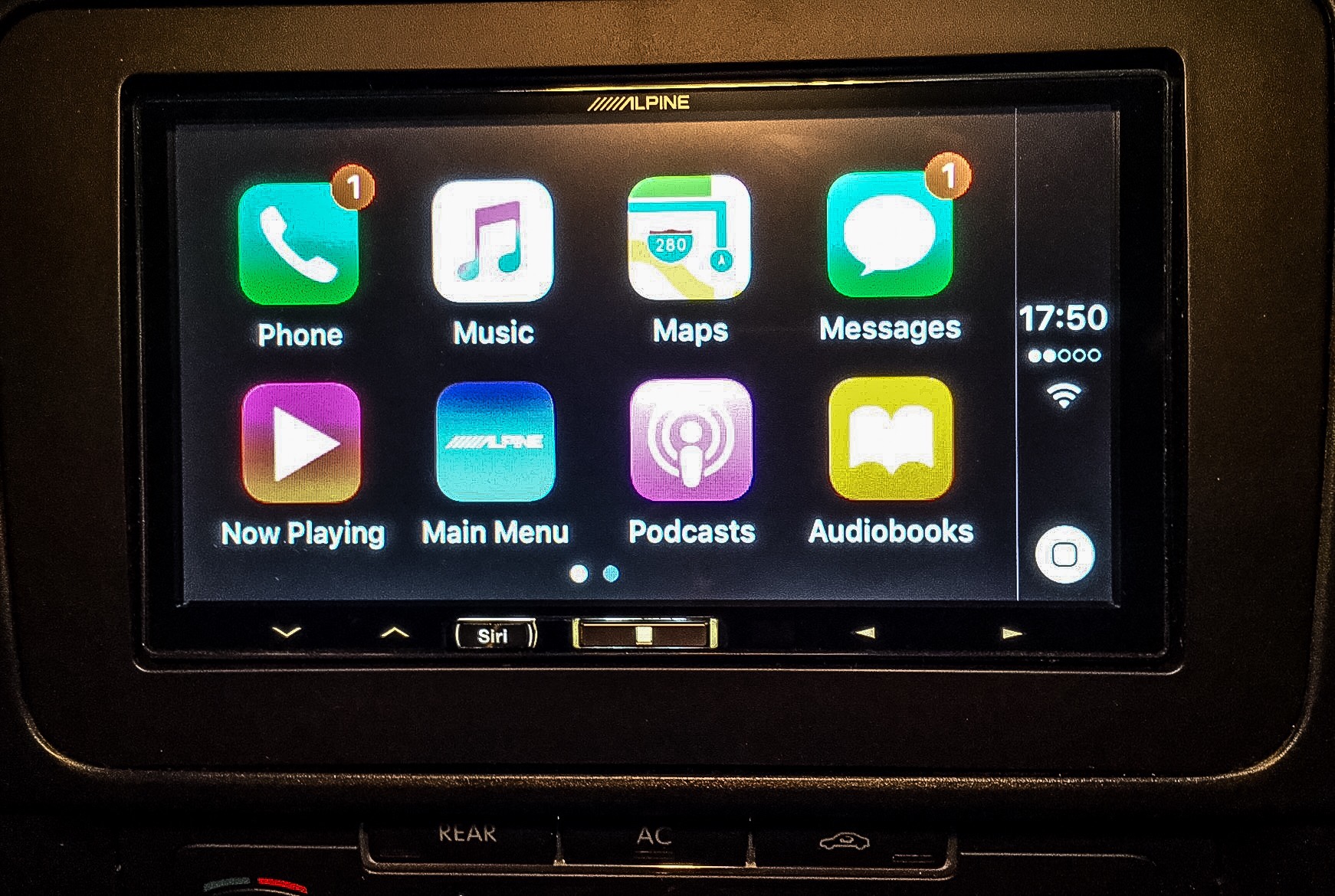

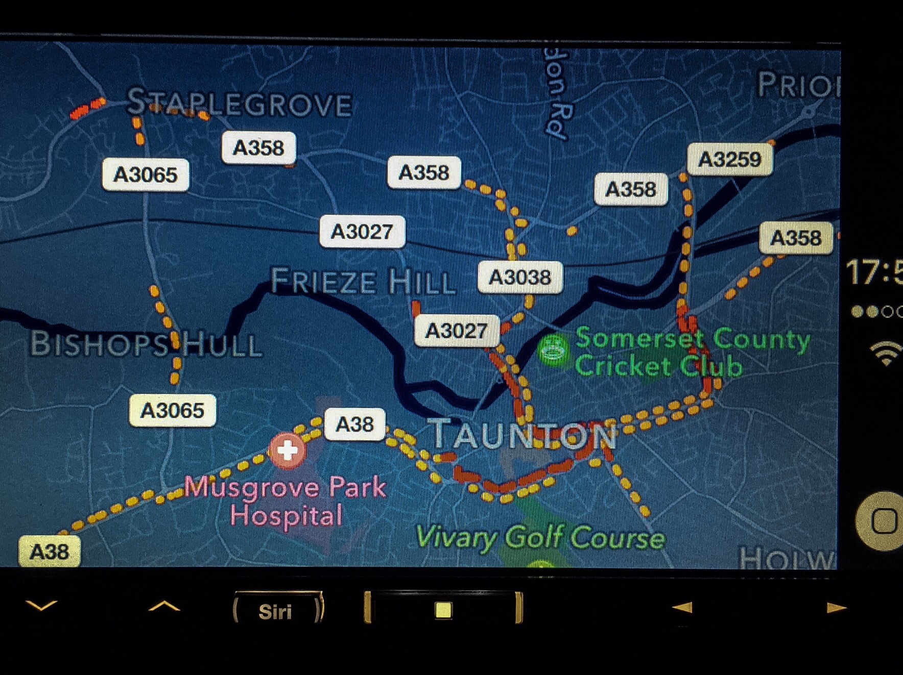

I couldn't wait for winter to get a move on, here are some (rather dark) pics

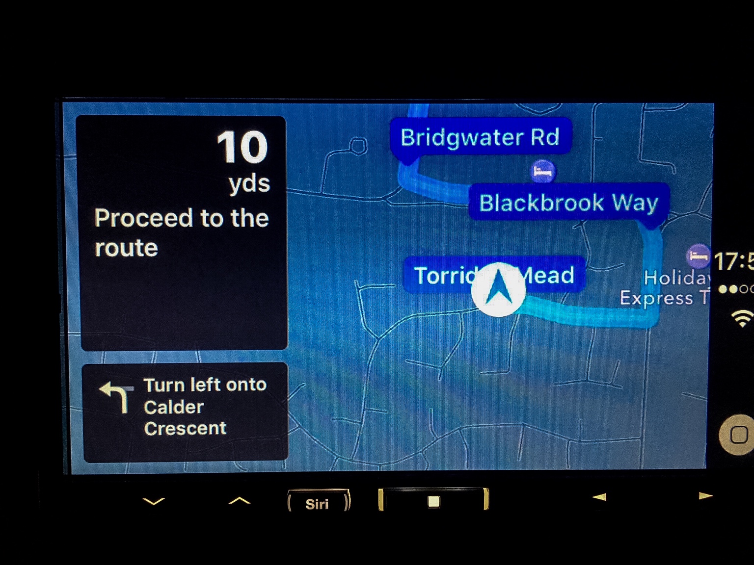

I quite like having the maps on displaying the area I'm in, rather than having TBT nav on. Apple Maps obliges nicely
TBT is nicely laid out and clearer than the split screen option on the RNS (it needs to be as there's no DIS nav display but you don't really need it now)

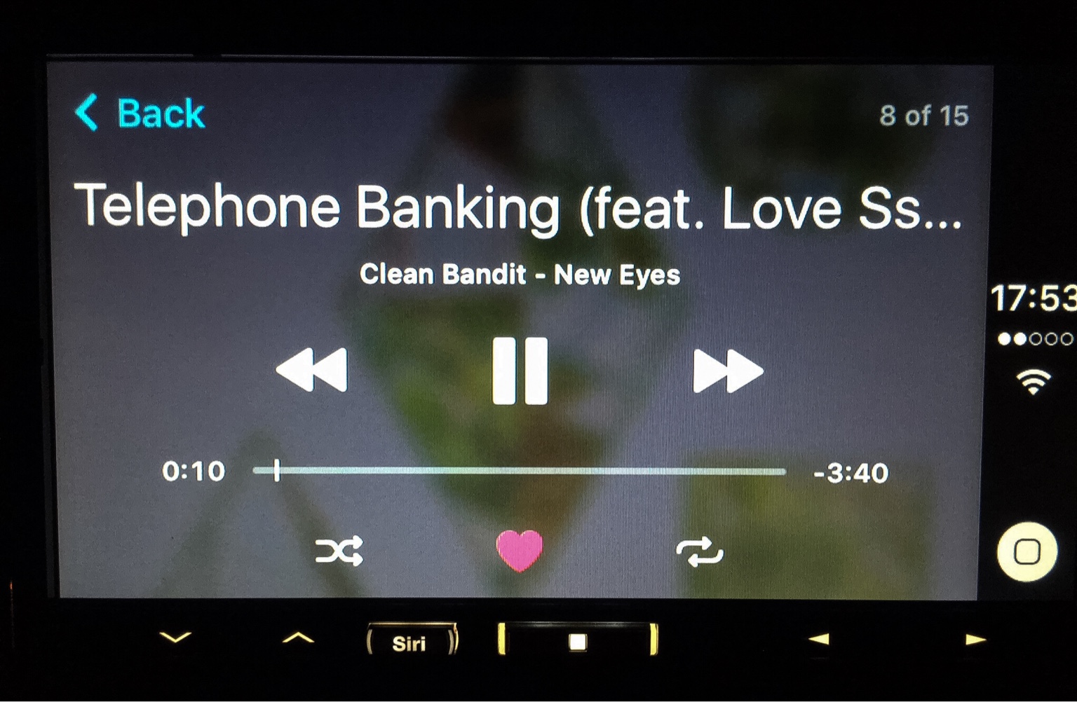

Also displays the song titles in mahoosive font, with album art sort of ghosted behind. Way better than some random artwork block and a piddly little bit of text. Like muchly so far!
I'll have some more of a play and possibly start a new thread where those of us with CarPlay can contribute.
The great thing about this is that voice activation really does work. You don't even need a Siri button provided you're happy saying (but not shouting) "hey Siri" and following up with "drive home", or "read new messages", or "play...." It's actually quite liberating, if slightly nerdy!

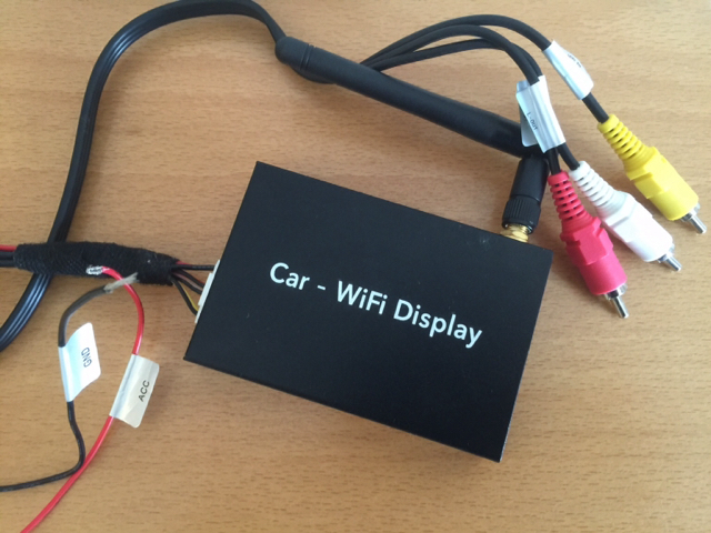

So far so good. I've had the head unit fitted together with a wireless device "xlink" which allows me to mirror my iPhone screen. There's a couple of adaptors I needed but it was quite straightforward. Effectively I can now run any app (including sat nav) and display it on the head unit. Using it this way you must control the app from the phone, the head unit is display only.

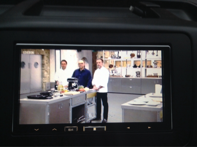

An added bonus is that video can also be played including iTunes, BBC iPlayer and my go-to media app, Plex (YouTube and Amazon video don't work however)
Bit of master chef anyone?

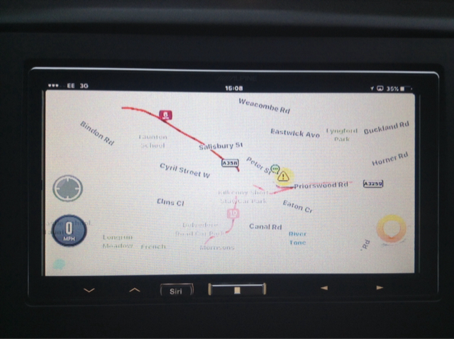

Waze shown here, but any work including the self-contained versions that require no/minimal data usage.
The pictures (taken on my older iPad) are a bit lacking in clarity, the screen display is actually a lot better than it appears.
Xlink was around £40 from China on eBay. There are more expensive US versions but they don't work as well. There are also some sellers in the UK, which is a better bet if you need help. I work in IT and so it was fairly straightforward to set up, but make sure they have updated the firmware to the latest version as iOS 9 changed the way screen mirroring works. I had to update the firmware myself and it was an interesting experience!
The two adaptors were cheap enough. The cable to connect the red/yellow/white AV cables on the xlink to the 3.5mm mini jack on the head unit is a Kenwood item; CA-C3AV about £12 on eBay (UK seller but came from Germany). You must use this type (not a camcorder cable) as it has an "Apple configuration" which means that they earth the thing via the tip, rather than one of the "stripes". Apple, eh? There are others but the Kenwood part number is easy enough to search for and you know you've got the right one.
Lastly I got a microbypass "video parking brake bypass for Alpine" from eBay USA for £10. This enables video to operate whilst you're driving as the nav apps need this (so no, I won't be watching master chef on the go!). I've since read that just earthing the parking brake cable to the head unit chassis can also do this (but I've not tried it).
Why we can't source these items over here is a bit odd, they're cheap enough to buy. A further side-benefit of this Xlink is that an Android can also be connected and used in the same phone-controlled way.
