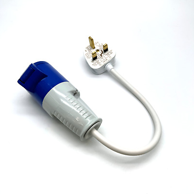

We got our new Cali a week or so ago. It came with a pathetic 2 metre long charging cable. However with the cali in our garage it is just the right length to plug in to a nearby socket for charging. But of course it has a German 2 pin plug on the end of it. Does anyone know if there is an adapter to enable me to plug it into our regular uk 3 pin supply? .
It would be a clat about using our 25m cable in the garage.
You've got two choices - pop to Halfords or similar & pick up the uk version of the lead for a fiver
alternatively if you are never going to use the 2 pin lead cut the plug off & stick a Uk one on.

I’d buy a UK one which we did and use at home very infrequently. We have both in the boot to use in home charging emergencies. The EU one has come in handy at my daughter’s house in France several times. They cost peanuts from most stores or sites inc eBay and Amazon. Buy some cable and use the two ends to make any length you want. Unless you leave your Cali standing for weeks on end you have no need to plug in at all.

Thanks for that. Went and checked. It wouldn't fit in the socket anyway because of the spring loaded lid. Glad i didn't cut the end off to fit a plug. :rolleyes: :)
The spring loaded lid shouldn't stop it fitting the socket, the lid clips onto the outside of the socket on the van to keep it securely in place.

Search on Amazon for a Schuko to UK plug adapter, they are there, I have used them for my model trains for years.

Schuko adaptors are two a penny on eBay, different types suit different applications.
