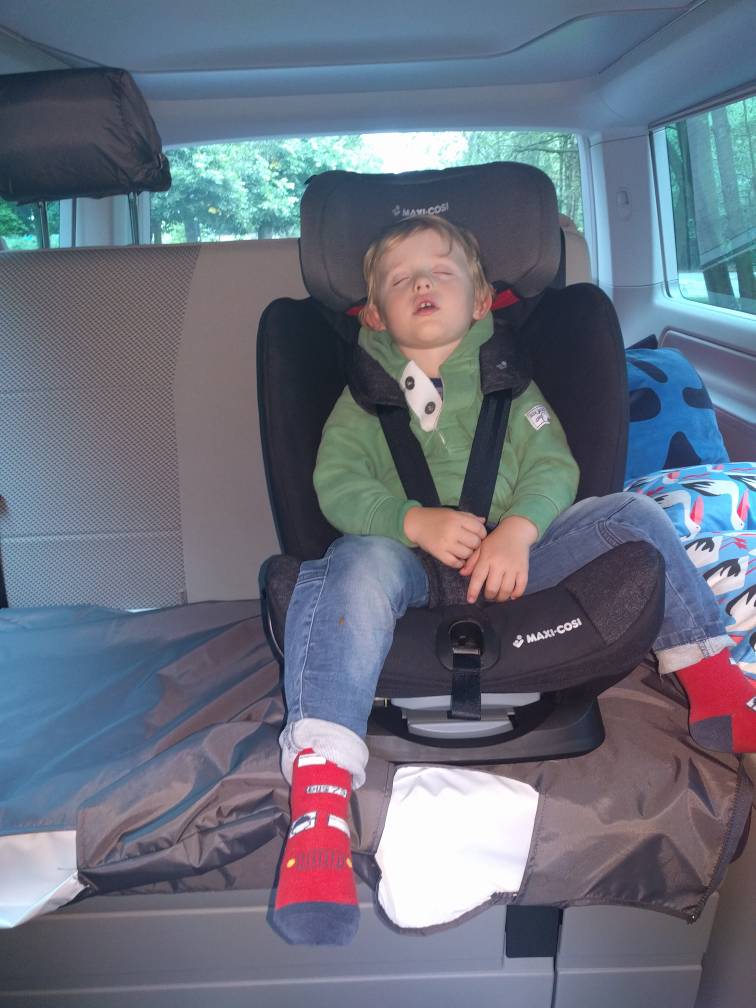

We just got this maxi Cosi titan from Halfords it first with isofix and is really stable.
Previously we bought the recaro hero which straps with just a belt but found that the car seat tilted sideways when we went round corners.
The guy at Halfords checked the fitting of the recaro hero and was surprised, we also tried the it in our be touran and fit was better but not great.
Halfords let us try seats in our cali Beach until we were happy with one.
The isofix was the best fit even if a bit fiddly to put in and out when sleeping. We find that if you tip the bench seat back slightly it helps with the fitting.
The seat we chose can be seat belt fitted at an older age so will see how that fit is when the time comes.
We are happy with this seat and I am sure fitting in and out will get quicker with practice. Glad we persisted and selected a new seat with isofix.

Ours is the maxi Cosi titan pictured further up on this thread, fits with isofix but no foot to the floor. It's got 3 point harness so can be used from 9 months plus.
The harness then comes out and you can use the seatbelts to fasten.
The isofix location gets easier with time!

Hello - we are only using the isofix at the moment. I have heard mention of people using the tether point on another thread.
My boy is a tall 4 and still fits in the 3 point harness.
We previously tried a reccaro seat which used seatbelts only to fasten and the seat tipped when we went round corners!
We are happy with this seat and have it in our car too. It fits in driver's seat when we are sleeping.
