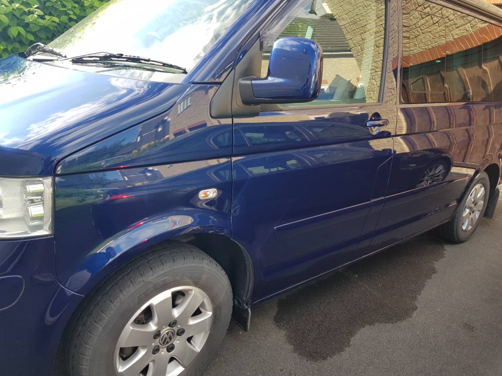

So with all this talk of clay, thought I’d give it a go.
Before....,,
and after....,.....
Amazeballs. :pinkbanana
