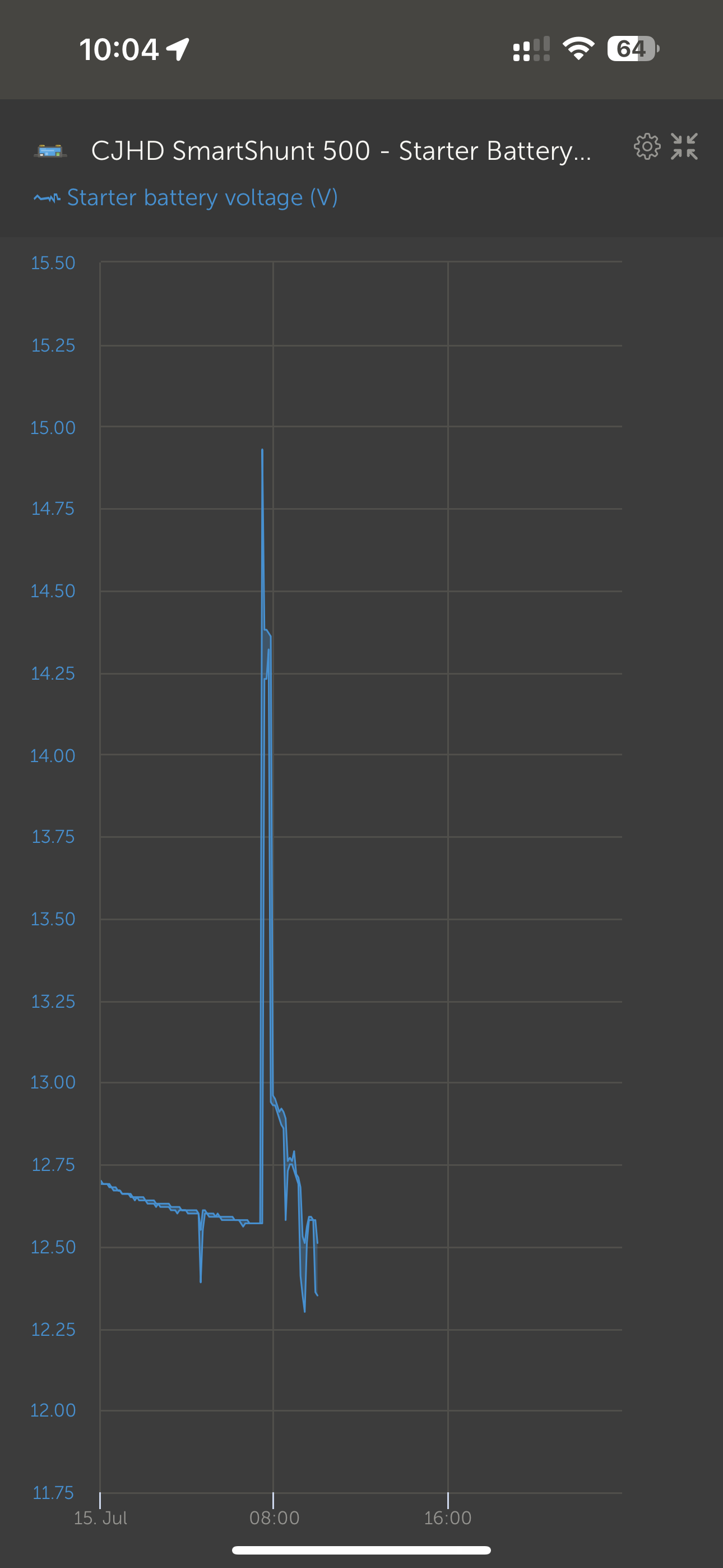

I have been concerned about the speedy decline in my starter battery’s voltage whilst sat on my drive unused when it drops 0.1v every 2 days and can now add solid data to my previous posts on this matter.
This voltage drop means that when not frequently used, I would need to charge the battery approximately every week. This seems excessive to me.
I had the VW garage take a look at it under warranty – it’s 8 months old – and the technician said there was nothing amiss and in particular no evidence of a parasitic loss.
Following this I purchased a BM2 monitor and after charging the battery for 24 hours, ceasing at 4.30pm on July 10th, the graph shows a fall from 12.82v to 12.47v in the 24hrs to 8.00am today.
I’m guessing I have a faulty battery?
