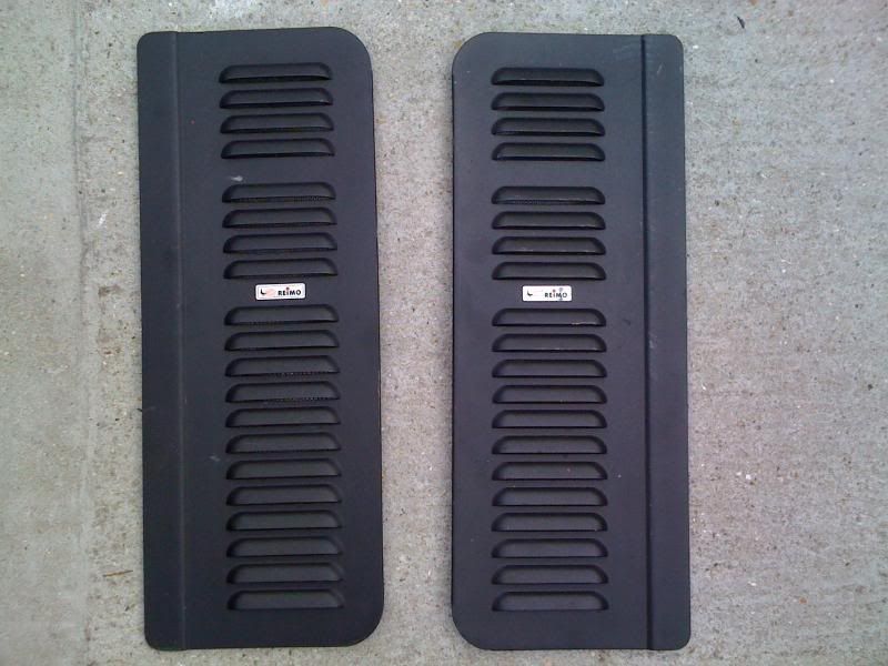

Ventilation is the key. we use vents in our sliding windows as well. Not sure if they are available for the T5, but this is what I mean:

Thanks TwentyOneThirtyFive. I'm pending to buy one of those air vent, they are sold for T5. Do you use them also when it's really cold outside? when snowing for example?

We use those vents all year round, having a little breeze is nicer than condensation build up or CO poisoning :)
