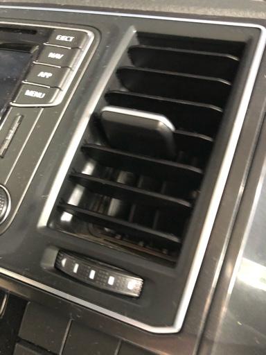

Sorry this might be a silly question but I have 2016 Cali Ocean and cant work out how to get air to come through the centre air vents on the dash ? Any ideas? Thanks
I have the exact same issue. The AC works and air blows from the outside vents but just not the centre ones. Any ideas on how to fault trace this issue would be very helpful.

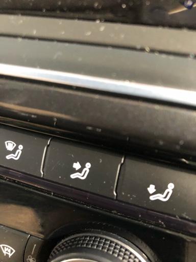

Do you have the forward facing air button pushed? (Middle)
& are the vents open (white marks showing on the dial)
Failing that it is possible that the actuators are Kaput? Did you hear the actuators move during the rest ?
