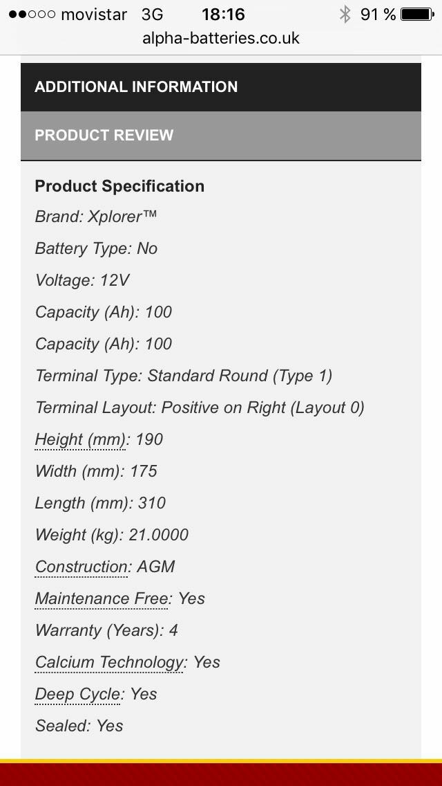

Just worth noting that you would need to check this battery once a year and top up with water as necessary, I understand the Vartas are maintenance free.
Not an issue so long as you understand that this is a required check..
Xplorer batteries need maintenance????
Maintenance free: yes
Fantastic.. Even better.. Great info on the site I saw them on said they required maintenance/topping up... I will look at these as a possible replacement for mine..
