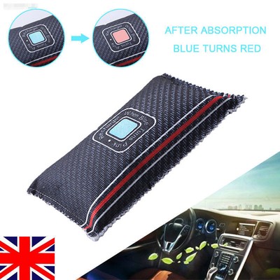

this looks a good deal. I done a couple of nights at 0-5 degrees with the pup and heater on low with windows closed. Woke up very damp
Are silica bags like these better (and quieter) than a 12v demudifier in this scenario?

Would be better to open a downwind window a bit and turn up the heater.

I know but I don’t like wasting energy. Maybe in spring to autumn, that would be fine but I’m reluctant to do so in winter
I know this sounds like a contradiction , but if you can check the humidity OUTSIDE on a cold winters day , it is often much lower than the levels INSIDE the vehicle .
In this case open the doors and windows and flush out the damp , stale air .
I deal with flooded buildings - the first thing we do is open all the doors and windows for a couple of hours - then shut everything up , and start a drying programme .
If you shut the vehicle up with a heater on - you will just heat up the damp air - no wonder it was damp when you woke up - I bet the vehicle was full of condensation .
With all respect, you will be using energy to heat the silica gel to dry it out once used...

I think a microwave using electricity (on a “renewable tariff”) is better than using the diesel, even if it is a minuscule amount. I‘d consider using a diesel heater with an open window to be no better than using a patio heater. If someone wants to do the math, I’d happily change that.
I’d much rather put an extra layer on than even put the heater on in the first place.
Or am I alone in here in trying to minimise my carbon footprint? (and yes I know the hypocrisy in me buying a diesel van in 2019 - but it’s better than the alternative of flying long haul).
I suppose the best option would be a 12v demudifier, powered by the leisure batteries? But my question for the group is how effective is that?

Must get one of these microwaves that produces no environmental pollution, and I’m not just talking about CO2.

Silica gel bags work by absorbing moisture until they saturate, then become useless until they are dried, usually by heating them. They are silent compared to a 12v (or any powered device).

But then you have to burn energy in the microwave to dry the silica bag out.
Put the silica bag in the oven after cooking at home or safely in the engine bay when driving to dry it out and save energy :)

I like your thinking. Engine bay is nice idea. Or when oven is cooling after Cooking
