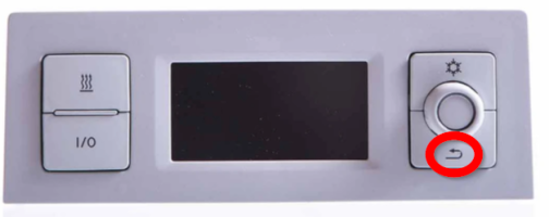

My 'back' button, the button on the right bottom of the control unit, has a different logo/image:
The new panel has an arrow:
Is it safe for me to buy this panel as long as the numbers match? Or do I have to check some other things?
And if all is OK, can I just order the panel and plug it in? Or do I still have to go to a dealer?

That panel should plug straight in without issues
