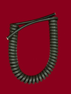

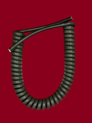

I created my own curly cable by winding some 12AWG 2 core cable tightly around a pole. I secured it with tape and left it in the warm sun for a couple of days, then steamed it for good measure. It held the shape nicely when I removed it and after a month or so and a bit of roof use now shows no sign of loosing the coil/shape. Cost £10.
