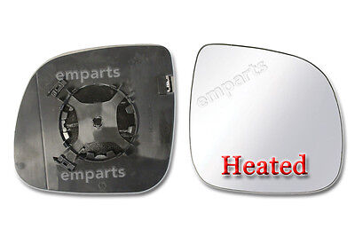

I got this glass and have replaced it. But despite it stating it is a direct replacement for a 2015-2020 T6 the spades for the heating element are in a different position and the wires are not long enough to reach.
the original is on the right below. It’ll do for now but I’ll have to get either an original or better alternative for winter.
Show the picture to the supplier and he may replace it with the correct one or you could always extend the wires at a push.
You need this type ...
I’ll try that - not too bothered for £14 - I’d happily have paid that for a temporary replacement. I could try to extend the wires but I don’t want to cut them so that’d mean finding the right spade connectors.
