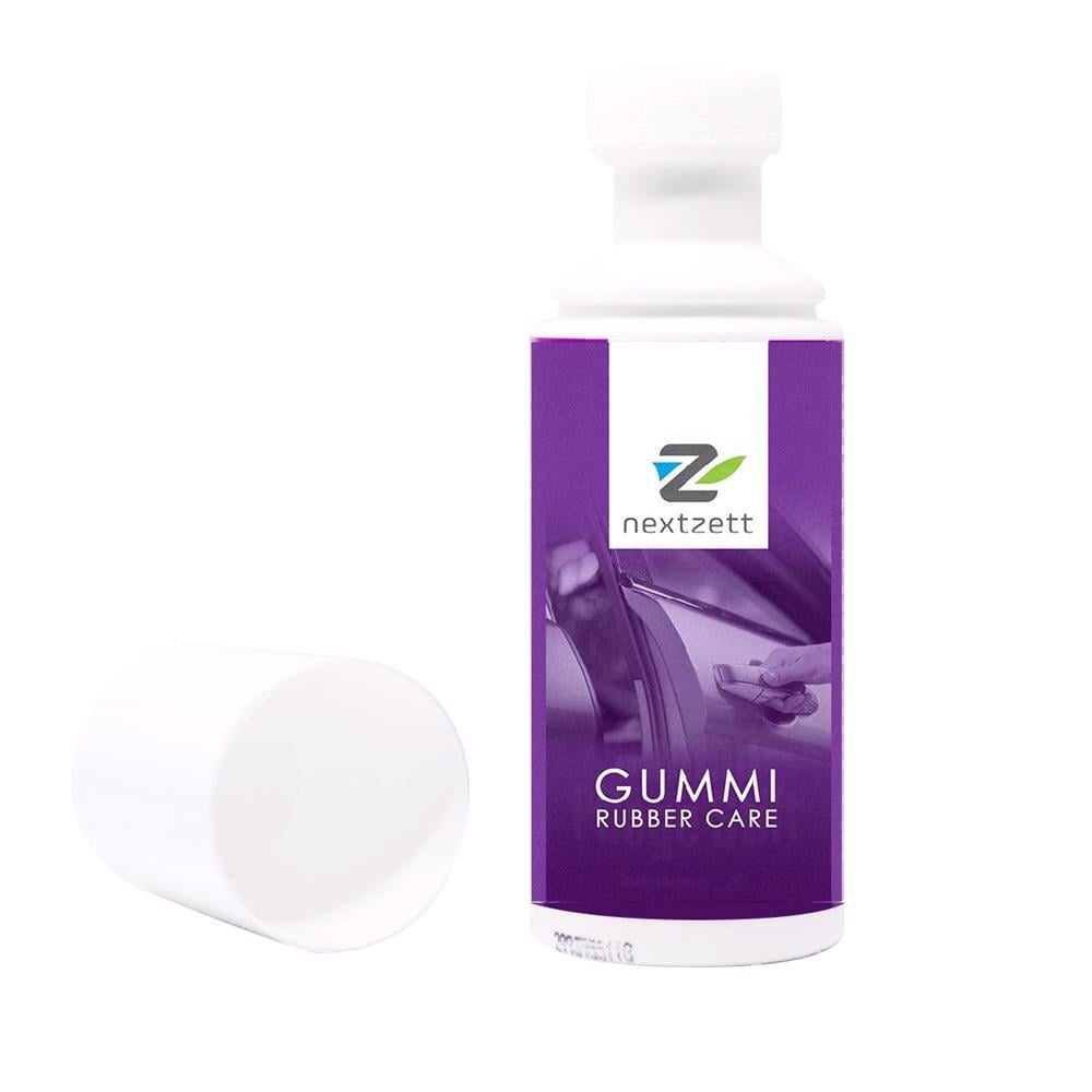

On the subject of the door seals, something that many people will have around the house without being DIY oriented,
you can use a shoe polish sponge, the type that apply a shine to shoes without colour, to apply a thin film of silicone to the rubber Seals
Prevents them sticking, repels water and dirt and bring them up better than new

That'll work fine, any liquid silicone will work but I use this Gummi-Pflege regularly ...
I use Gummi Pflege for all rubber on the van and my other vehicles, including under the bonnet, hoses etc (I know I’m OCD) not everyone will have Gummi or want to buy it, so just offering up other possibilities with a common household item
