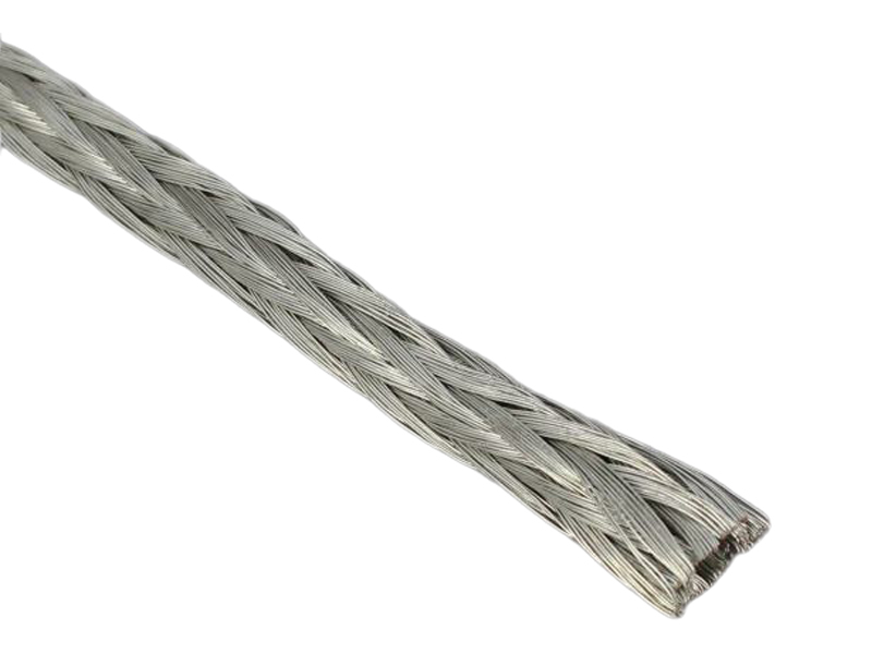

Hi can anyone advise on buying the earth cable. I’m about to do mine on my 2008 cali, I’ve read loads of posts and seems easy to do. My question is do I have to go through the German site for tge cable or can it be bought in the uk or something that will do the same job. Thanks
Or a bit of this and a couple of crimps for half the price?
Thanks for the reply’s Halfords sell a similar one called a braided earth. I just want to make sure it’s going to be fit for purpose. The caliground one has a plastic sheath around it. If tge braided one does tge same job I’ll get that and crack on. Thanks
It’s an earth brade. Insulation is optional. If you feel like it, warp some tape round it.
