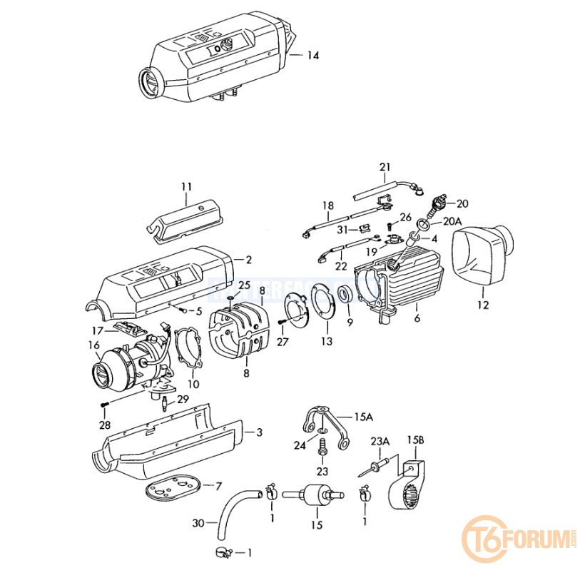

Later T4s had a D3L which is the same footprint as a modern Airtronic etc. all of the mounting parts are different to the early version but I think it ducts into the same inlet and outlet inside the vehicle.

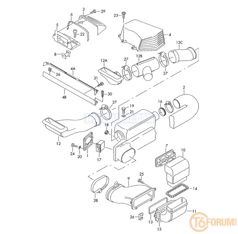

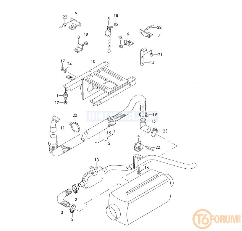

Diagrams of heater fitment on a 1996 T4...
Note that is for a LHD vehicle so the heating air intake is through the side panel not through the step. (Item 10 etc.)
full
full
full
That’s really helpful Rod. Thanks
