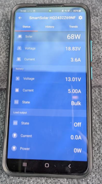

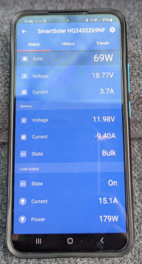

Hi all, what settings are people using with their EcoFlow or other battery packs for the load side of the victron? I managed to flatten my leisure batteries over night, this is the first time I’ve used the solar setup to charge the ecoflow, I was expecting to it to start charging when the sun came up this morning not draining leisure batteries overnight.
I'm using one of the user defined settings from memory? I think it's set to turn the load off if the battery drops below 12.5v?
Yeah I tryed that too, I even changed the voltage to 13v on the low setting, and dispite the battery being at 12.4v it still fully charges on the load side
TBH I've only ever checked once at night and it had turned the load off, perhaps I've just been lucky. Looking at the app now it says something about changing a jumper too? Not sure if it means the yellow one on the bottom panel? I have the 75/15 controller btw.
