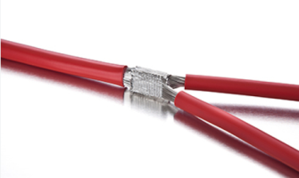

Does this make it a bit clearer. The joint you can see is the common sensor feed that is spliced at the ram.
{EDIT} Just an example but the splice will probably look like this (just an example not the Cali) - it is ultrasonically welded and will be taped or heat shrink.
Ah…..thanks so much vbk175……that makes perfect sense……based on this, I guess it is worth me removing the tape to inspect where the common sensor feeds are spliced……I’ll take a look later…..thanks again.
